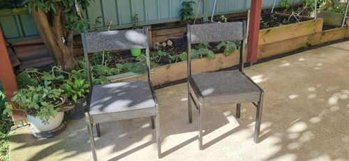

Step 1
Took the seats and backs off the chairs and used timber from other chairs to form the side support for top shelf.
Used pyywood cut to size to form bottom shelf anf fixed by wood screws.
Used floor boards cut to size and screwed in to top form top shelf.
Used the pine wood to form three supports for top shelf.
Finished with half round moulding.
Finished
