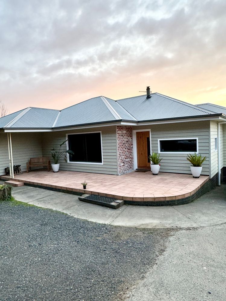

And, here is the reveal. It's so nice to have a vision and see it come together. It has been a massive few months with this outdoor reno, but we got there, well almost! We still have more renos to come), but for now, we will endeavour to finish some painting once the weather picks up and then move on to the front porch and its roof (which will give the front entrance some weather protection).
