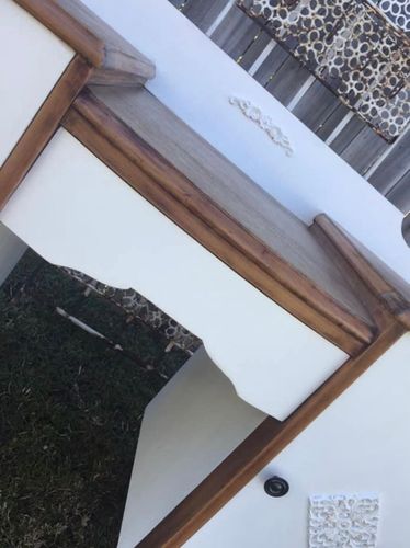

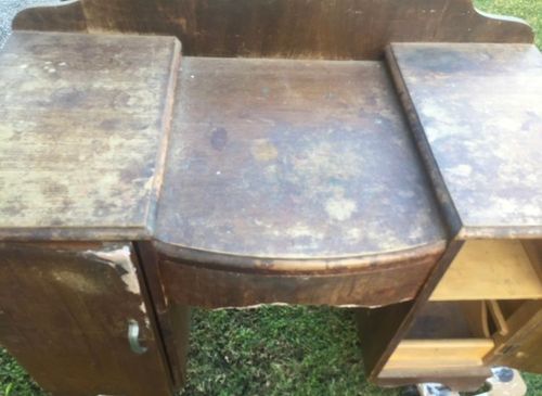

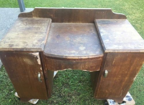

Remove old handles and give it a good wipe down. Patch up broken wood and give it a good sand.
Step 2

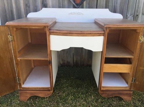

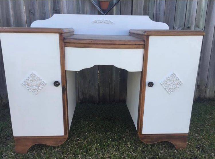

Sand the cupboard , only light sand on drawers, doors and sides but the top I gave it a good sand. I stick on the decorative moulds and applied 2 layers of 123 Zinsser undercoat & 2 layers of chalk paint on the sides, doors & drawers.
Step 3
The top I used Cabothane varnish 2 coats
Step 4
The inside I painted as needed.
