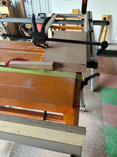

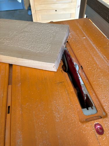

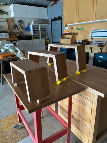

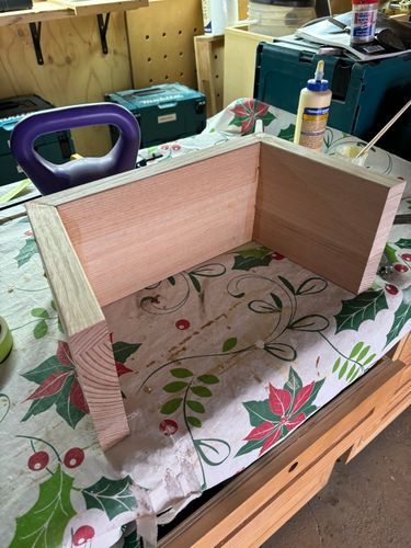

Cut angles on each board on Triton Saw table
Step 2

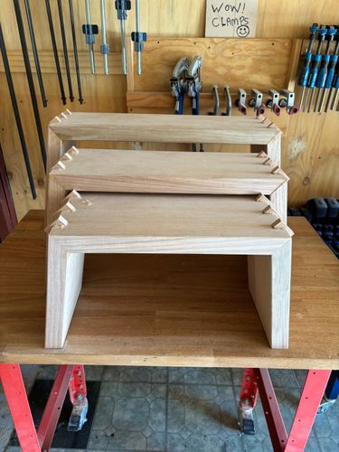

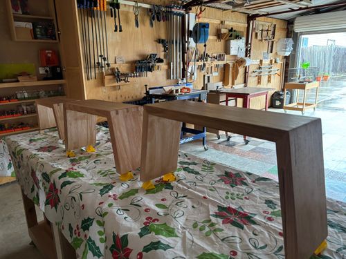

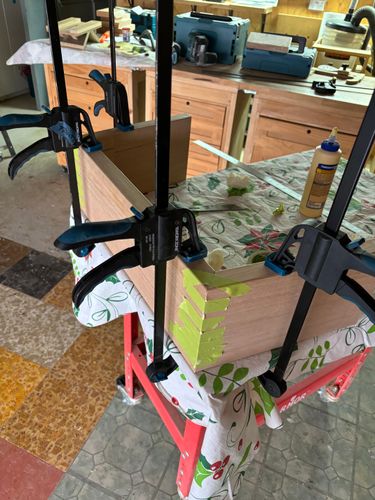

Glue up and clamp together for two of the stands, for the third stand I used superglue with a spray accelerator and the wood glue, this worked well , no clamping required.
No clamps used for this one, just super glue and wood glue

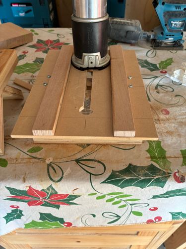

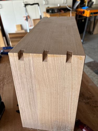

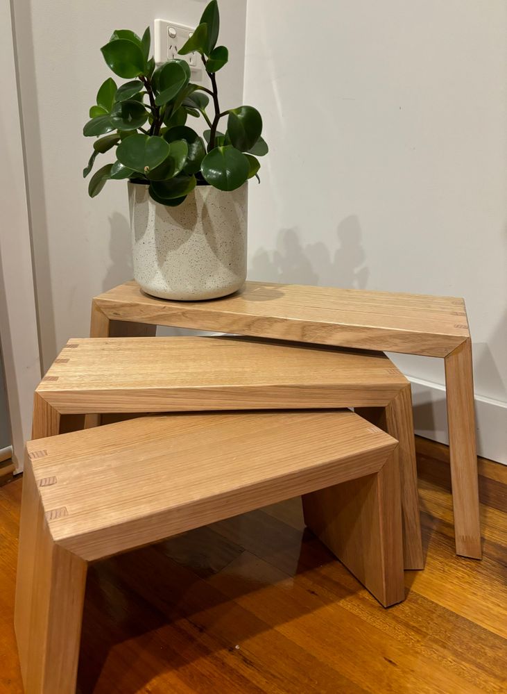

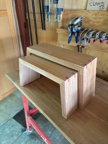

Make up spline jig and cut and glue splines
Spline jig

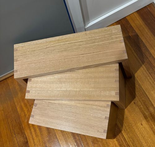

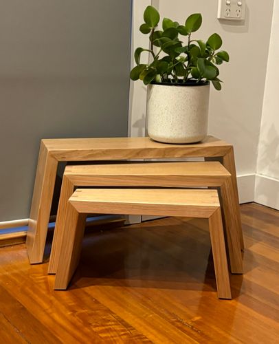

Sand and paint, I used water based clear varnish, applied with a piece off cut sponge, (no brush marks)
