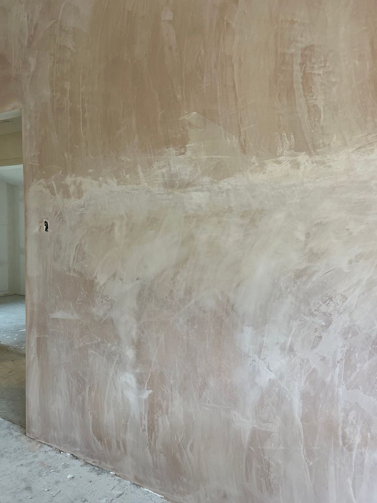

After removing old paint from unsealed walls, we decided to skim-coat them with British Gypsum Thistle Multi-finish. This is a hard plater regularly used in the UK, where a watered down emulsion (ceiling paint) is applied as a base coat, before top coat.
Is there any reason to use a primer in this scenario? The walls are not chalky, they are solid. There is no need for oil-based primer so deciding between water-based primer and diluted ceiling paint. Both pass the tape test after 24 hours.
