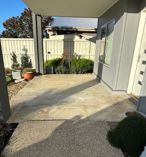

This is where the Front Porch started

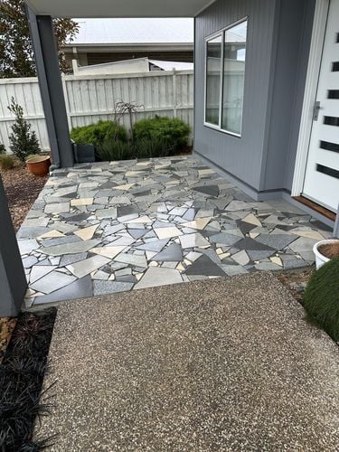

The during process

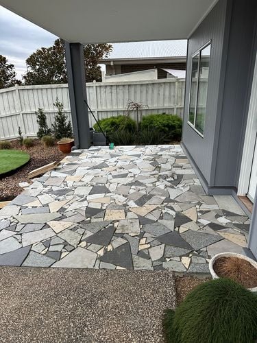

With the first section laid we spent over four hours fitting every piece in, this made it so much easier when it came time to add the adhesive

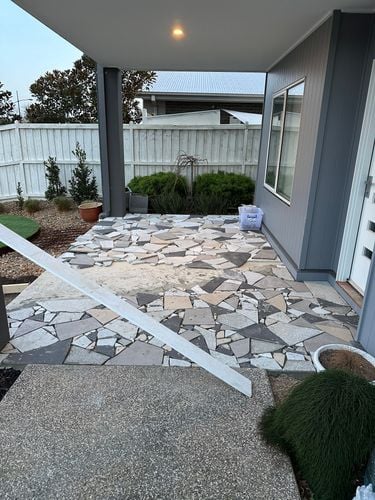

Once all the tiles where stuck to the concrete we needed to grind the excess adhesive from the top of the pavers, this is where my big tip came in - clean your pavers with a damp sponge as you add the adhesive

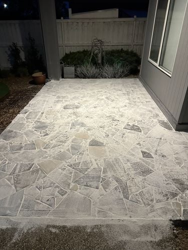

I add the grout with a dry process (instructions for this process in step one)

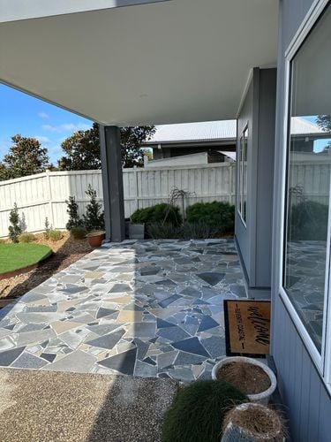

The finished product is beyond my wildest dreams. Absolutely over the moon with how it turned out
