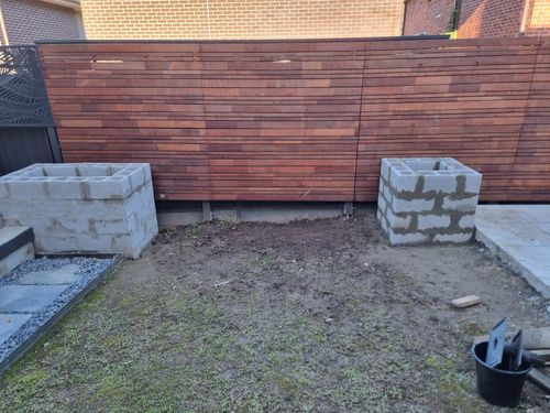

I have built two garden beds made of cinder blocks but I don't like how they look.
My thought was to render the besser blocks.
- I know there are some online videos about how to render. Does anyone have any the steps to guide me? Like how do I create a professional and smooth render look ?
- I have seen videos of rendering where the is first layer of render and then lines are drawn across it and do 2nd layer. Is that neccessary?
- should I use textured paint to paint it after rendering?
- what is the best render material to get? is there light grey colour?

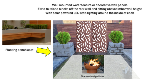

- On a different subject, I'm looking for some ideas to create something between these two garden beds. Not sure if I should create a decorated area with pebbles and some fountain?
