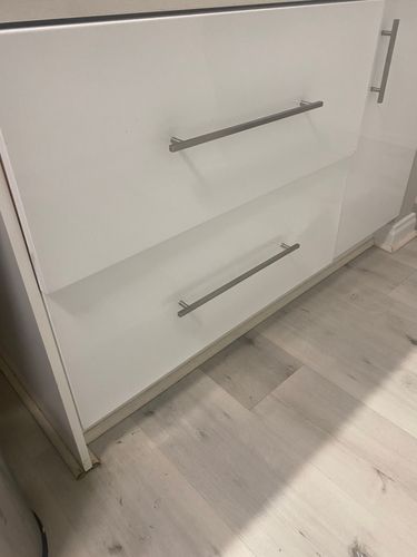

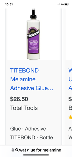

Thanks Mitchell,not sore if you can see the photos ,cheap kitchen i guess ,is it laminate and is that glue ok
Hello @jackndiane
It is a laminate material that is attached to your door. I suggest using the contact adhesive suggested by Mitchell as it is designed for use with laminate materials. The Titebond glue you mentioned is for timber-to-timber contact only and will not work on the laminate material.
