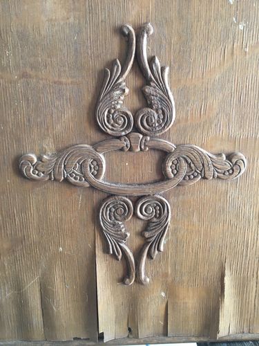

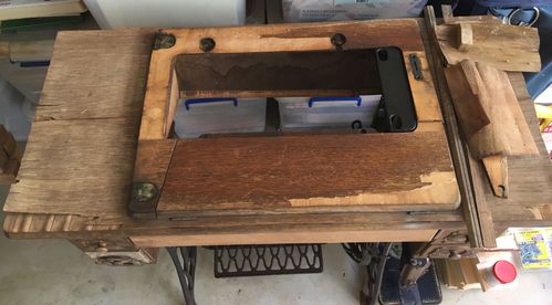

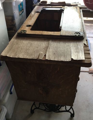

Remove old sewing machine and unscrew drawers from treadle machine base. Remove broken and cracked old ply with chisel, hammer and nail pincers. Singer sewing machine motifs were partly broken on front of some drawers and sides of the drawers.
Removing old ply
Ply removed and kept for template
Motif on side of drawer, to be removed and restored

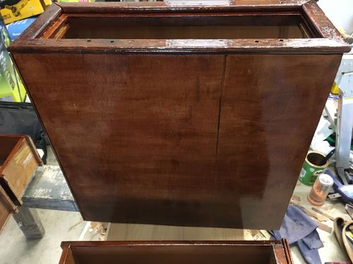

Purchase marine ply and use old ply as template for new pieces. Cut out new pieces using a jigsaw and hand saw.

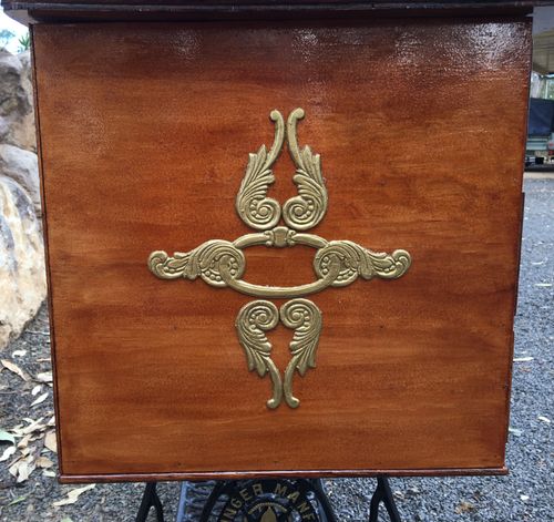

Varnish new pieces.
Varnish drawers and sides
Varnish sides

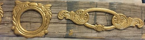

Paint removed motifs gold.
Painting motifs gold.

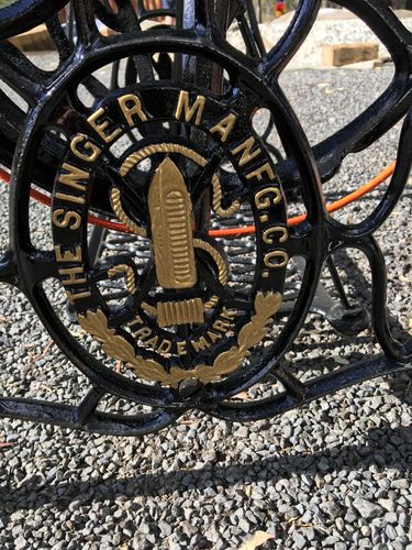

Paint treadle base black and highlight Singer company motif in gold paint.
Re-painted treadle base and company motif

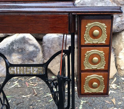

Glue and nail new pieces of marine ply onto top and sides. Re-attach gold motifs to drawers and sides.
Re-attach side motifs
Re-attach drawer motifs

Attach restored drawers to brackets on bathroom wall as storage unit.
Installed drawers on bathroom wall

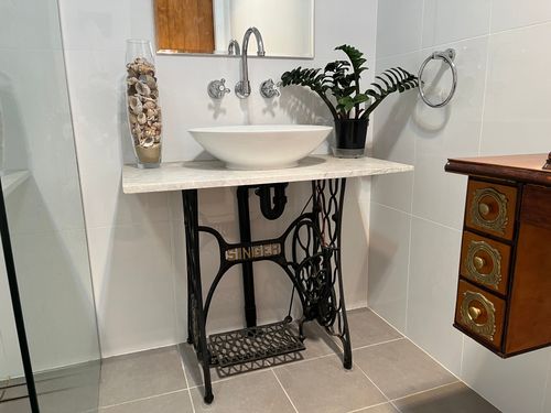

Place painted black treadle base against bathroom wall.
Attach piece of recycled white marble on top of treadle base to hold bathroom basin. A local plumber cut out the hole in the marble for the piping and installed the taps, as I did not have the tools, the qualifications or the necessary knowledge for this step.
Basin installed on restored treadle base and recycled marble piece
