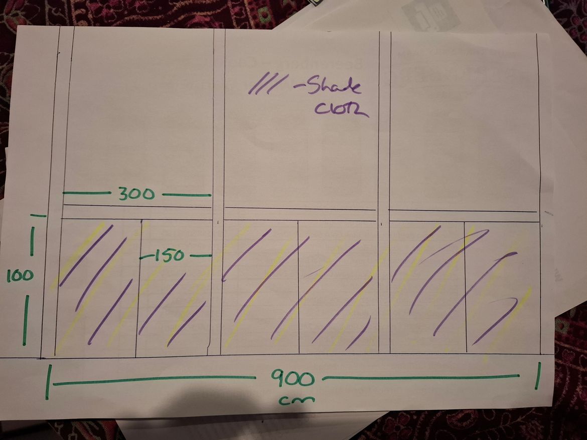

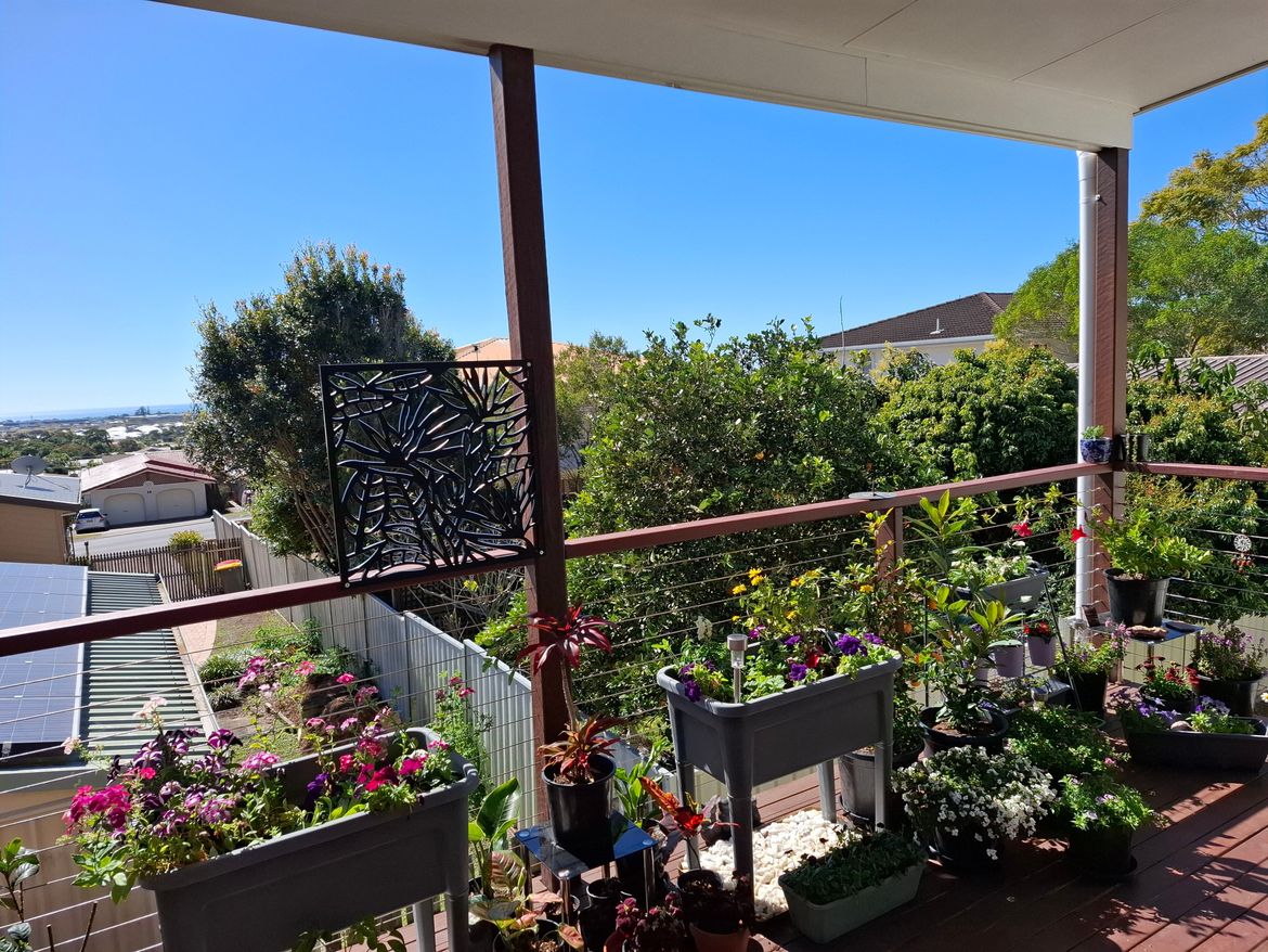

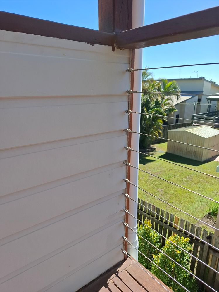

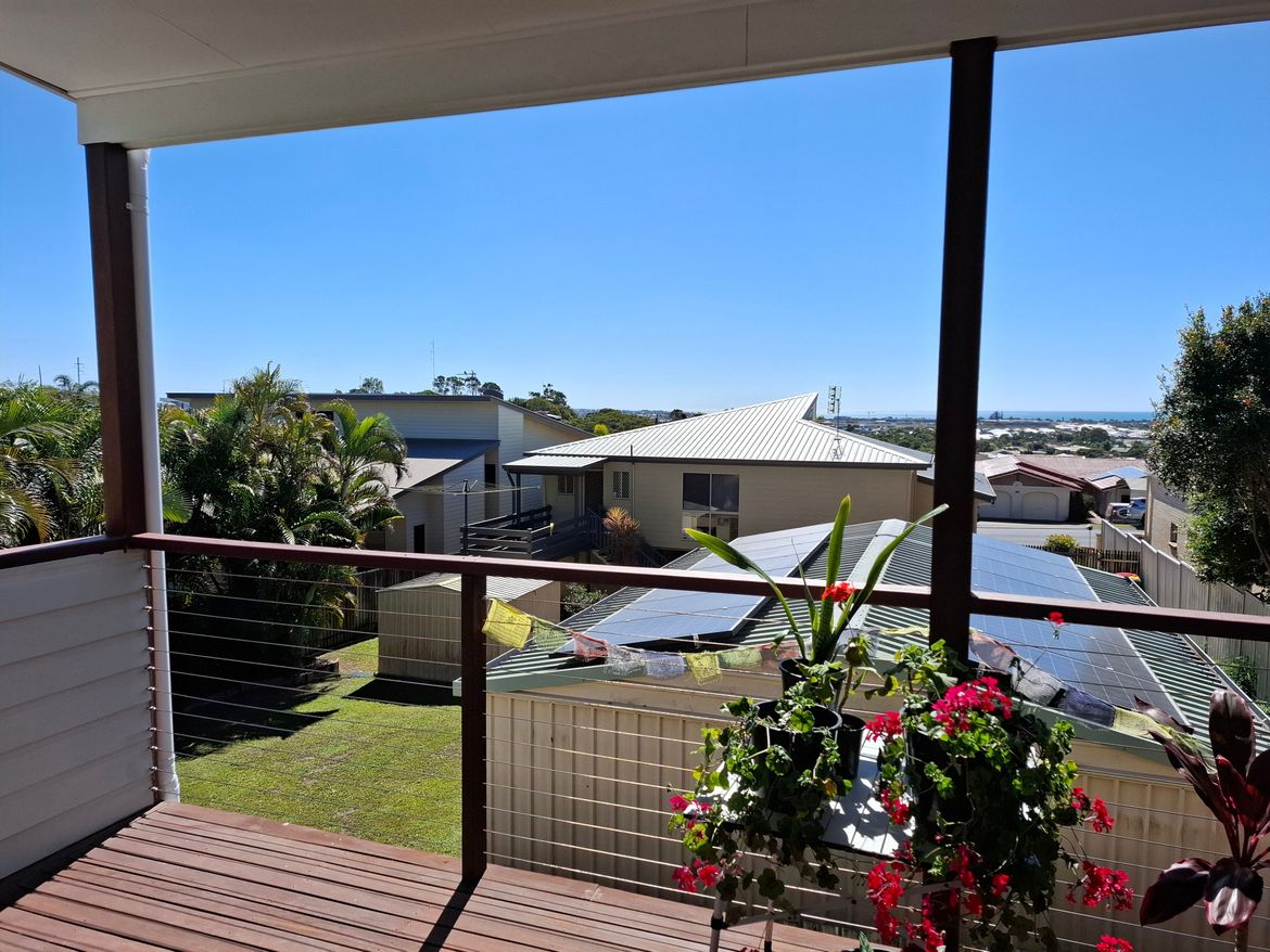

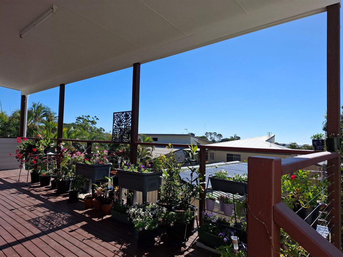

I would love to hear different options on how to attach shade cloth to the lower part of my balcony - also considering the 2 ends.
The plants will be moved.

In order not to damage your balustrade with staples, I suggest building a simple timber frame using 42 x 18mm 5.4m Moulding H3 Treated Pine FJ Primed 4 Edge Pencil Round LOSP. You can build the frame to suit your needs, and it can be mounted using a minimal amount of screws. Depending on the type of shade cloth you're after, I propose having a look at Coolaroo 3.66m Graphite 90% UV Heavy Duty People Cover Shade Cloth. The shade cloth can be stapled to the frame and the frame can be mounted right in front of the balustrade.
I've placed a sample image below to give you an idea of how you can build it in sections.
