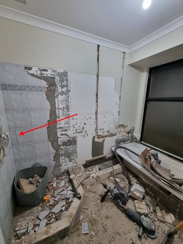

Picture below shows where I was planning of putting it.

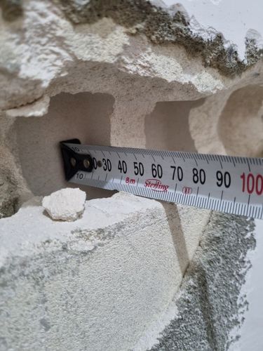

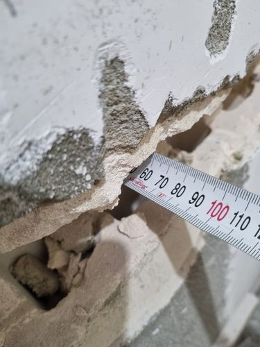

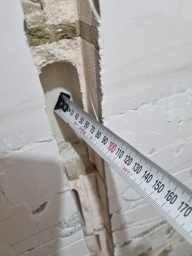

Plan is to only make a crevice according to the brick, i.e. not put a hole in it through the wall.
The brick itself will have a backing of at least 20mm, based on measurement. With the facia cement render included, there should be at least 75mm depth of the niche.
Will this work?
