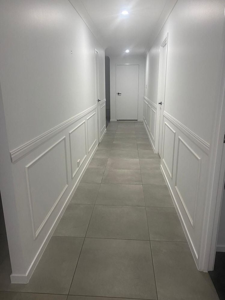

Panel moulding used to create a feature on the plain walls of an entry hallway.
The project
Decided to decorate the entry hallway walls with panel moulding and I think the results came out pretty well. Wasn't sure if I would be able to do it but this forum has been very helpful for asking questions every time I got stuck.
I think it came out very well and has truly transformed the space. Hopefully my effort inspire other people to take up similar projects as well.

Took the measurements of the walls and draw a rough plan on paper.
Step 2
Marked out the outlines on the walls to get an idea on how it looks. Really recommend Stanley 1200mm High Impact ABS resin spirit level from Bunnings.
Locate the studs and use a tape or similar to mark out the location.
Cut the Pine mould to size. I used the Craftright Mitre Box to cut the Pine.
Stick the mould on the wall along the pencil lining. I used Selleys Fast Grab Liquid Nails and nailed them into the studs using a Ryobi Brad nailer. The vertical panels I only used glue as they did not line up with the studs.
Fill the holes with wood filler.
Step 3
I ended up with joints between the moulds so used Timbermate wood filler. A tip would be to use this as little as possible. I was quite generous initially and it became a time consuming task to sand it all down.
For the chair rail install I would really recommend using a laser level to get your line. I used 66 x 11mm 5.4m Moulding White Pine FJ Primed Colonial SA1. Double check the chair rail height from the top of skirting is consistent all the way through. Use the Stanley spirit level as it also has a ruler. This is to make sure you get it a perfect horizontal on the chair rail.
Step 4
Tape around the Pine to prime it. Remove the tape when the primer is dry.
