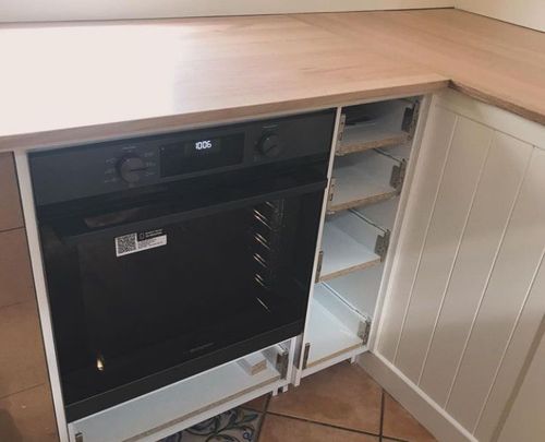

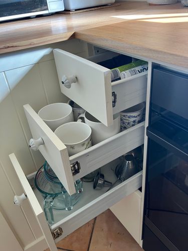

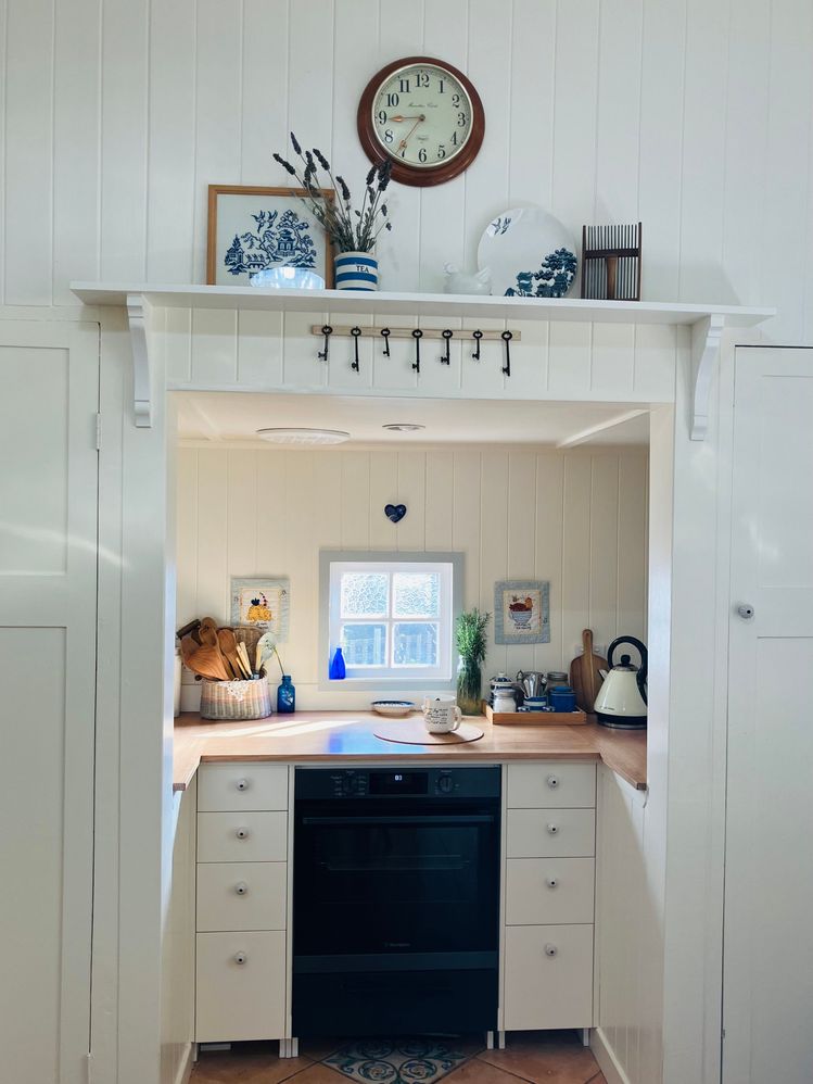

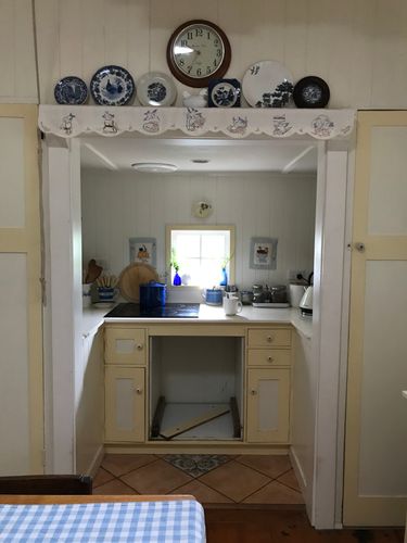

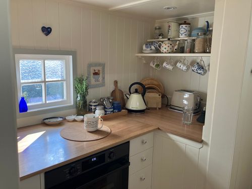

Most of my work area is enclosed in the old stove bay. Needing to replace the oven I decided to make the area more functional, replacing deep narrow cupboards with drawers and the plywood benchtop with Tasmanian oak.
It’s working beautifully now! I chose not to have a cooktop at this point but have a single plug in induction burner which I’m finding better than I expected.

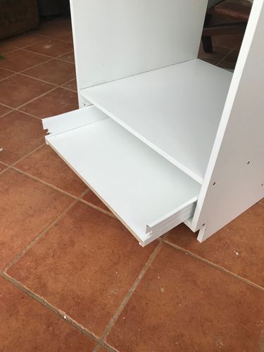

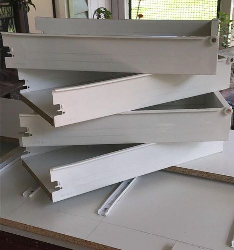

Made the drawer and oven units. There is nothing square in this kitchen! I chose not to use under cupboard legs as I’m using the space to store flat baking trays and such (eventually in box drawers) This is where I learned how important it is to cut square edges so I made a jig to line the handsaw up against which thankfully worked well because the next step needed it.

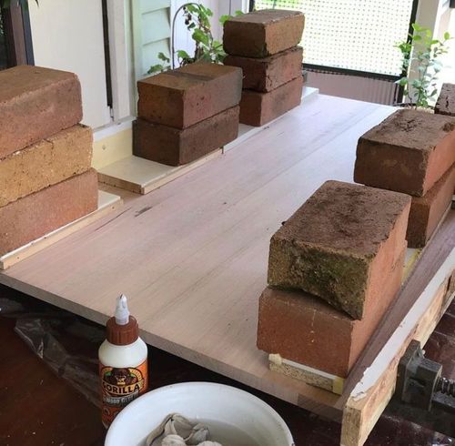

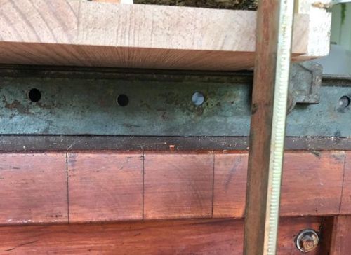

Once the drawer units were in place it was the scary moment of working on the benches in an area with 3 walls, not one square to another. First I had to dowel join the panels. I needed 2 plus a strip of Tasmanian oak for each of the 3 pieces. I made a jig to keep the holes level and used the double ended dowel things to mark the adjoining holes. I used long clamps and bricks to hold them together while they dried.

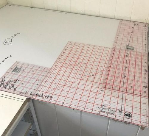

Using coreflute I made templates for the benchtops. I decided to leave the existing painted ply in place (filling in the cooktop top hole with a piece of scrap melamine and a bit of swearing) for strength and hopefully a bit of stability as the panels are only 19mm thick. It seems to have worked well.

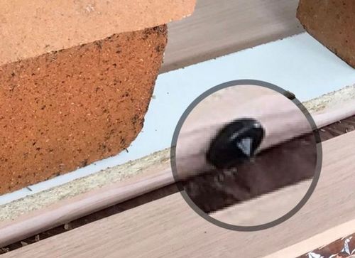

Because of the tightness of the space I couldn’t dowel join the two cross seams so used the super strong gorilla glue and crossed my fingers. It’s been there since Easter with no problems. I used wooden pegs around the edge to hold together and allow a bit of expansion room.

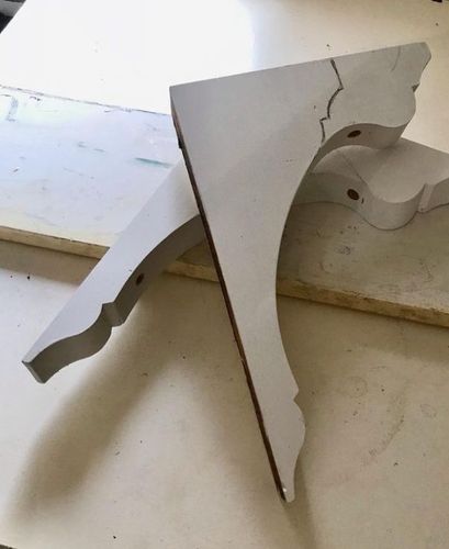

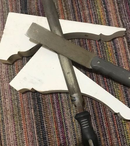

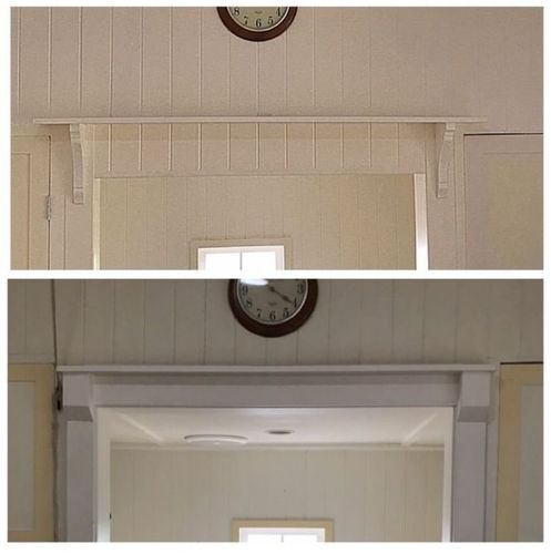

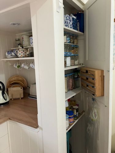

The ‘frame’ of this area was improved using 2 veranda brackets for the mantle - modified to fit which I’ve also used to hold the shelves inside the area.

And happily in use!
