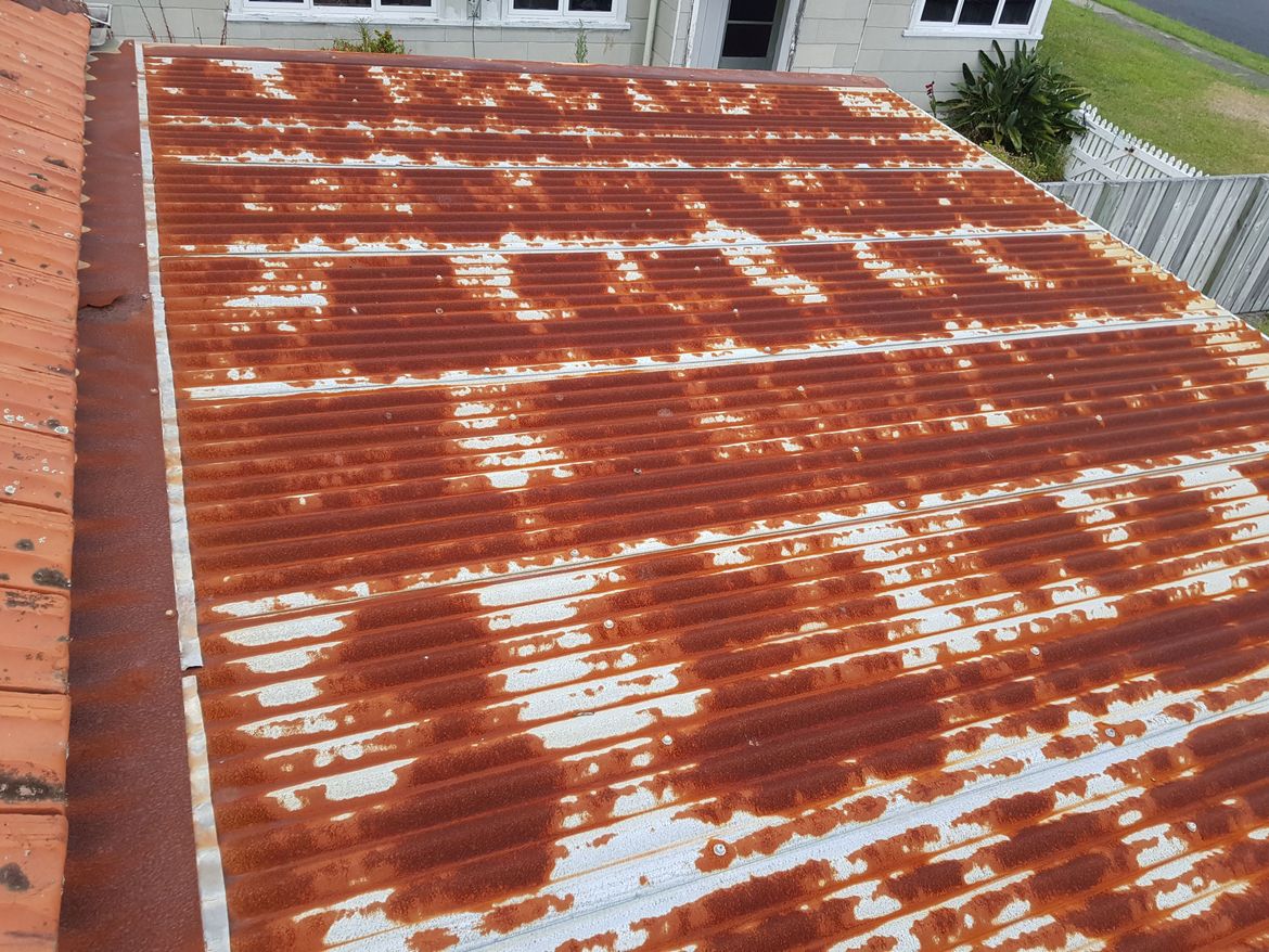

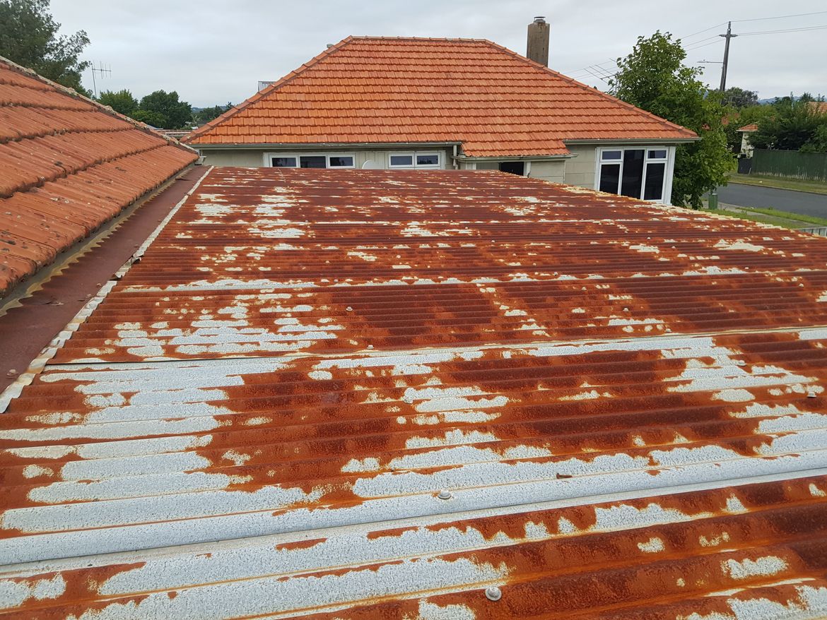

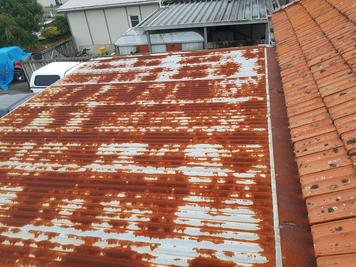

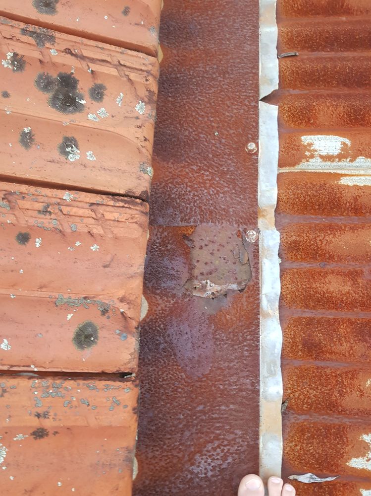

Where do I find the rules and regs of replacing a roof? Part of the house still has the original 1950s corrugated roof with the old lead nails. It's hanging in there but only just. Wanting to replace and add insulation at the same time. As being a flat roof extension there is no internal access.
