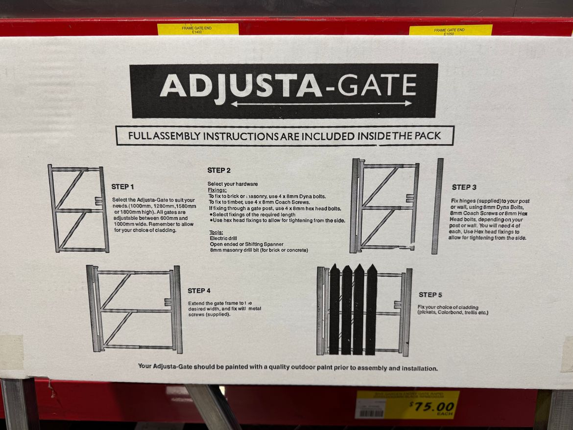

How do you install the top hinge? The bottom one is fine; that can be installed without the gate. But if you install the top hinge before fitting the gate the gate won't go on because the hinge goes down into the top of the gate. And if you install it after you can get a screwdriver bit in there to screw it in.
I've also tried to fit it beforehand by almost fully tightening it and sliding it down onto the gate. But then the screwdriver bit is at an angle and won't screw. I've tried to get an Allen key in there too... no luck.

Hi @Lex2,
In step 3 of the installation instructions on the packaging it says - "Use hex head fixings to allow for tightening from the side."
I would suggest using hex head screws to fix the hinges in place. They will allow you to make the tighten them from the side with a spanner or socket set depending on the clearance.
