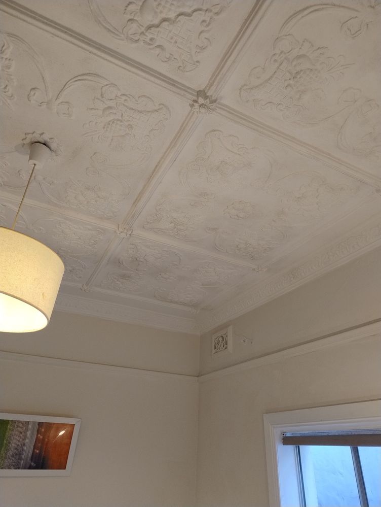

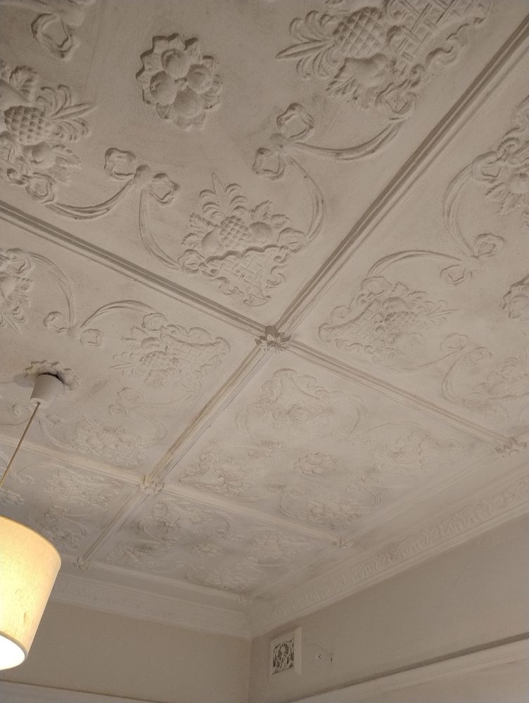

My house is 100 year old with ornate ceilings. They are generally in good condition. There is a thin coating of mold on these ceilings and i want to clean and repaint so it wont come back. - I have previously (about 5 years ago) repainted this ceiling with a kitchen and bathroom ceiling paint (specifically mold resistant from memory), but it only worked for so long.
I am thinking to firstly use Crommelin 4L Flat Aquablock Waterproof Primer Undercoat
https://www.bunnings.com.au/crommelin-4l-flat-aquablock-waterproof-primer-undercoat_p1560471?srsltid=AfmBOoqCagWmNclu6CFvWWEQnlSw9pbgLm66Wse1ssV0Bmtsb5575Zo3
Then use Dulux Wash&Wear +PLUS Kitchen & Bathroom Low Sheen Vivid White - 4LDulux 4L Interior Paint
https://www.bunnings.com.au/dulux-4l-interior-paint-wash-wear-plus-kitchen-bathroom-low-sheen-vivid-white-4l_p1370128
Is this a good combination to stop the mold regrowth?? Any one coat solution ideas would be great if it exists
Other question - is there a very long nap roller that i can use to paint the Ornate ceilings? I used a brush previously and it was tedious to say the least!!
It is very hard to increase ventilation in this old house so and i am aware thats the underlying issue. Pics below
Many thanks again
