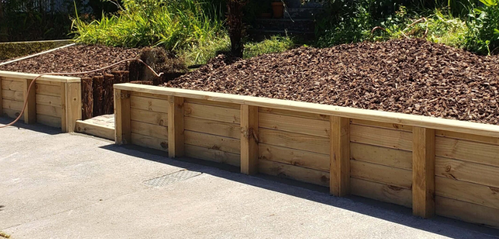

3. How would you cap these walls for a better looking finish? Comes down a bit to the final colour of choice. But as these sleepers are made of concrete you have the added complexity of how to fix the top board. Are you looking for a caping type look that you want to cover over the top row like below? 20 or 40mm Merbau would probably be the best long term weathering solution.

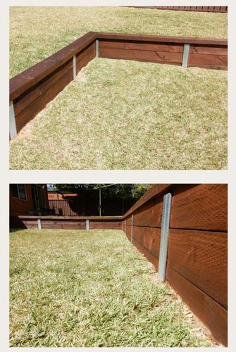

we are now thinking treated pine sleeper wall may be the go for most effective DIY using 75mm treated pine sleepers and steel posts with a capping. Max wall height is an about 600/700mm. a few questions;
- how do you fix the bottom sleeper to assure no movement, can you screw it to the post with a galvanized self tapper ?
- how far should you embed to bottom sleeper into the ground? There will be paving at the bottom of the wall.
- what is the recommend post spacing for 75mm sleepers ?
- we will either stain the timber like photos or would a external cladding like hardie fibre cement or something hold up ok fixed to the wall ?

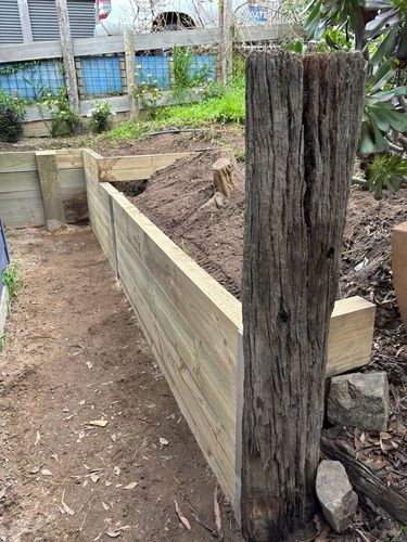

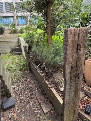

I've just finished replacing an old rotted retaining wall with a new one using Gal posts and 75mm TP sleepers. As my wall was between 3-4 sleepers in height, I positioned the posts on a slight angle back towards the high-point, so not plumb. This provides additional support from forward pressure when back-filling the soil. And ensure you line builders plastic to the back-side so soil can't bad its way through the gaps and helps to preserver the sleepers.
- how do you fix the bottom sleeper to assure no movement, can you screw it to the post with a galvanised self tapper ?
Yes but on their own the posts are too thick, so I pre-drill a pilot hole then use the either self-drilling screws or 50mm batten screws through the rear. But before doing so I hammer in shims in the back of the sleeper between any gap in the uprights to push the sleeper forward flush. Then fix the screws ins place.

Paint or stain would be the cheaper solution as there is no need to clad the front face unless you were after a particular finish.

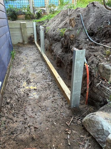

how far in the ground do you put first sleeper ? , and also what type / brand of steel posts are you using there ?
Ridgy the same brand your thinking @PscottDIY The first sleeper is only 100mm in the ground, which you can't see as I ripped one 2400 in half, then went full sleeper each one after. Crushed rock is yet to be laid in the path area. The images aren't the finished project hence the gap on that top return sleeper which is tomorrows job.
