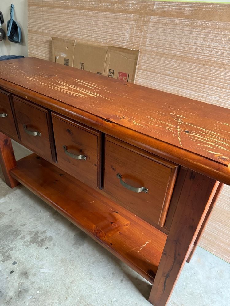

I wanted to update this old console to create a fresh coastal feel. I'm really happy with how it turned out!

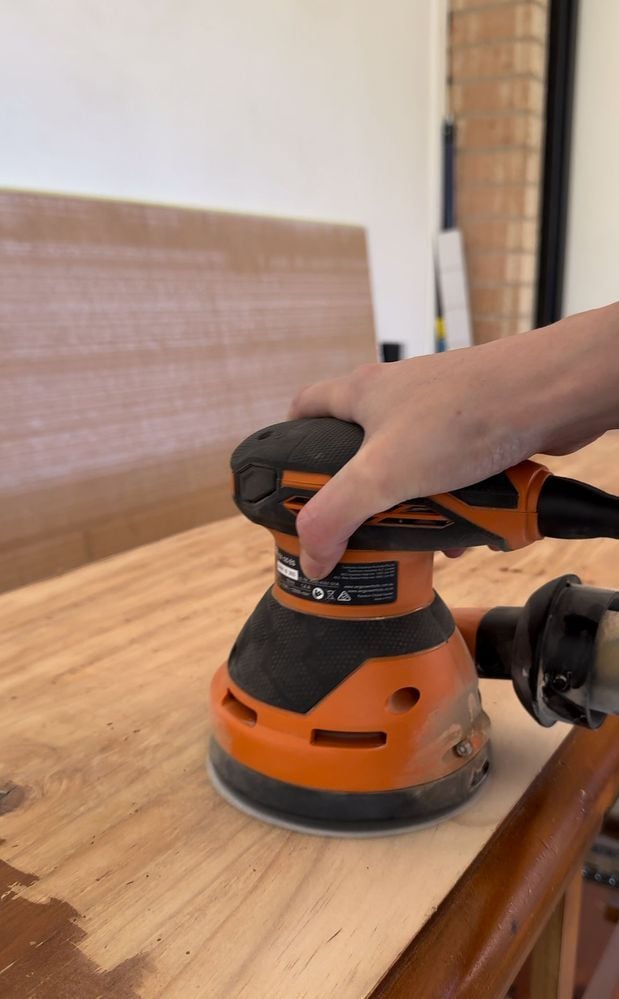

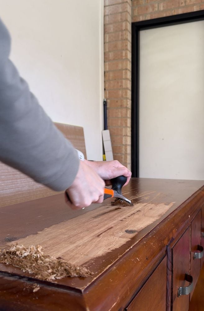

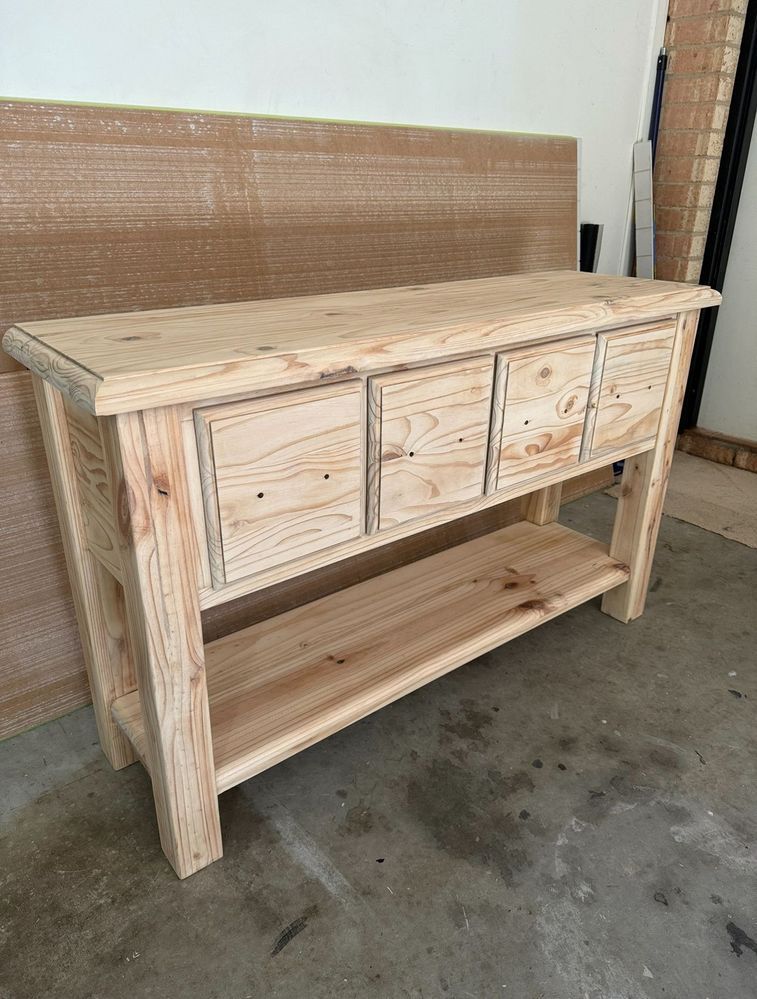

I started by removing the handles and all of the existing finish. I used a carbide scraper to remove the varnish, followed by an orbital sander to reveal the natural timber. I worked up from 120 to 400 grit sandpaper to ensure a smooth finish. I used my Ryobi multi tool as a detail sander for the hard to reach areas.

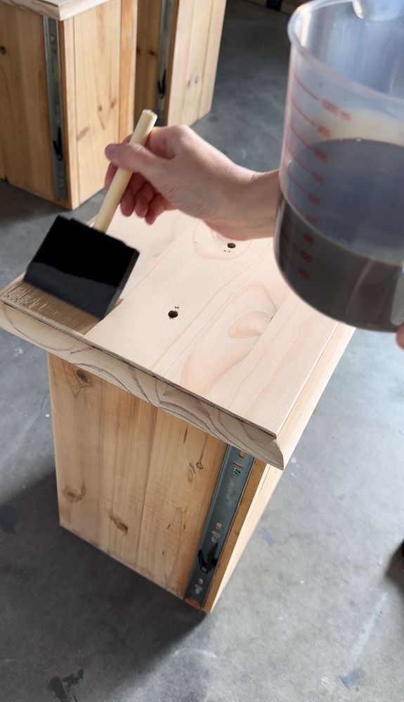

Once the old finish was completely removed, I gave the sideboard a thorough clean and applied a light paint wash (in Dulux Colorbond Evening Haze) to keep the timber from yellowing. I then used a foam brush to apply one light coat of Cabot's stain and varnish, followed by two coats of just the clear. I sanded with a high grit sandpaper between coats to ensure a silky-smooth finish.

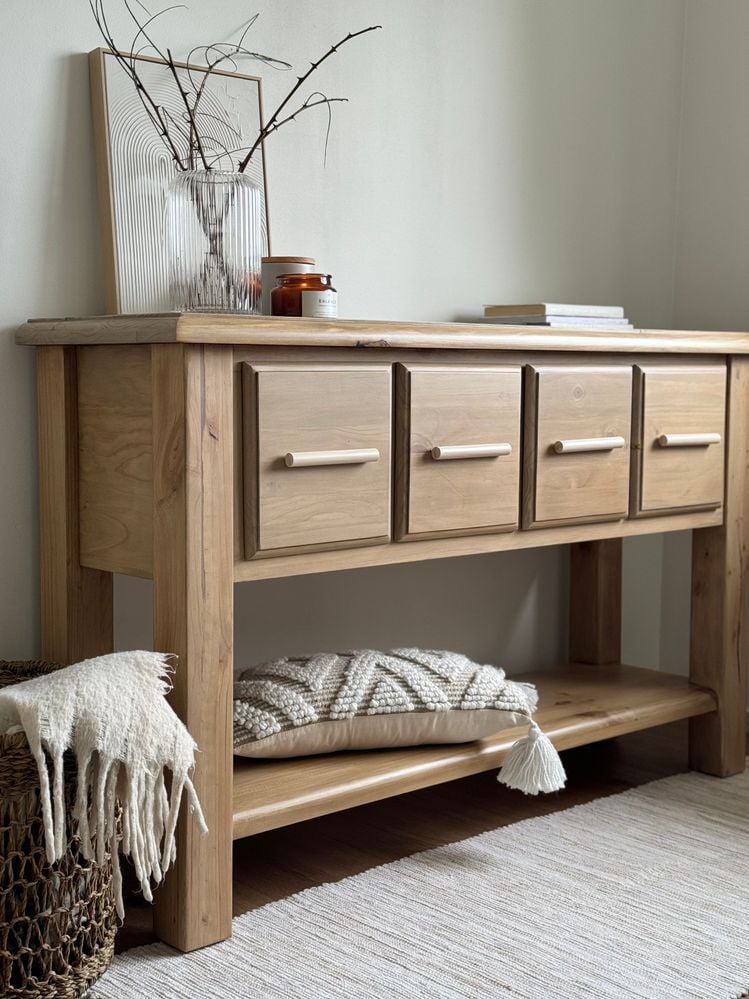

For the handles, I cut some pine dowel to size using a mitre box, sealed the dowel with clear coat for durability and fastened to the drawer fronts with wood screws. And this is the final result!
