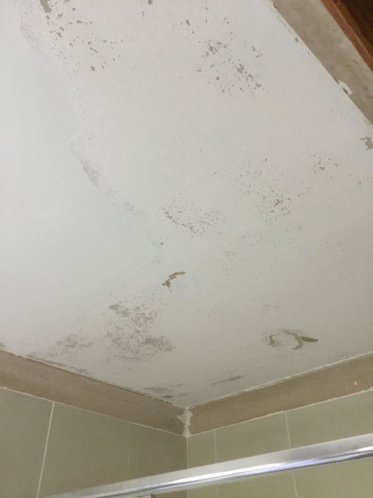

Ensuite bathroom upstairs has flaking ceiling paint and a leaking shower.

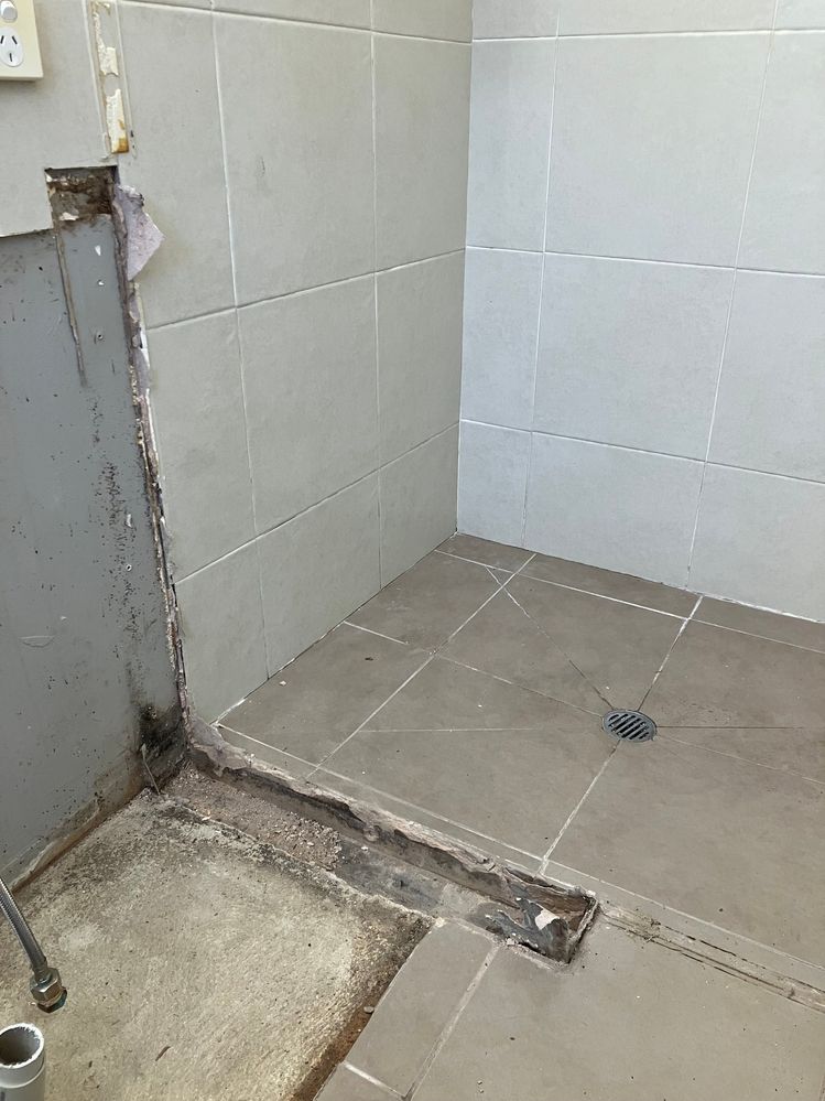

Thanks Eric for your advice. Most recent photos were taken after the vanity and nib wall were removed. There are no tiles under the vanity and water seeped into this well. Is it normal to tile under the vanity? Looks like the tiles will have to all be replaced to cover the whole floor. Grouting was never sealed. The ceiling is good now, we repainted it after prep and used the right paint. Do we need advice from a professional before proceeding with this project?

You've mentioned that the current waterproofing has failed, if it has to be replaced it will require the tiles to be removed and your walls relined. This means that everything will need to be pulled out and the entire bathroom gutted. The general steps to follow are the relining of the bathroom, waterproofing, tiling, grouting and the re-installation of the bathroom appliances.
Your ceiling will need to be sanded down, primed and then painted with a topcoat. In order to prevent moisture buildup, I strongly recommend installing an HPM 3 In 1 Exhaust Fan Heat LED Light With 4 Instant Heat lamps or similar. Since everything is staying in its place the the plumbing should not be very involved, but it's always a good idea to get the plumber to inspect the connections inside the wall before the bathroom wall liners go up.
