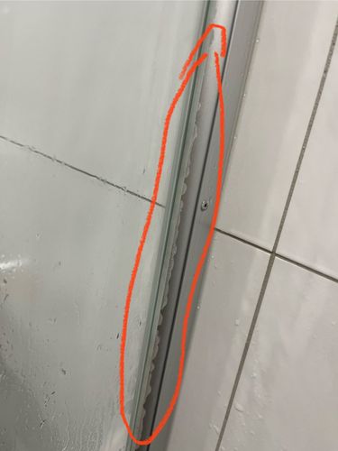

I accidentally damaged the aluminum panel in my shower. This was caused by a cleaning chemical. Please can you help me how I can fix it?

The cleaning chemical has stripped the cover layer of the aluminium frame. Due to the intense heat and moisture generated inside your shower cubicle any paint used on the shower frame will not last long in that environment. It is technically a cosmetic damage and will not affect the performance of your shower frame. I suggest engaging the services of a shower installer who might be able to resurface and polish that part of your shower frame.

are you able to recommend products I can use to DIY? Maybe spray paint?
Hi @KMac89,
As @EricL has mentioned, there are no paints designed to withstand the high-humidity environment of your shower stall.
You could try sanding the area with wet and dry sandpaper to make its appearance more uniform. You'd then likely need to polish the angle to restore its shine.
Be very careful working around glass as it can shatter easily. Wear PPE, including safety glasses, a long-sleeved shirt, trousers and enclosed footwear.
Thank you both @MitchellMc @EricL sanding the area and painting using pen paint worked. 🙂 thanks again!
@KMac89 what pen paint did you use? I have a similar issue with my shower.

I used sharpie silvery. You can skip the sanding. I suggest trying on small area first.
