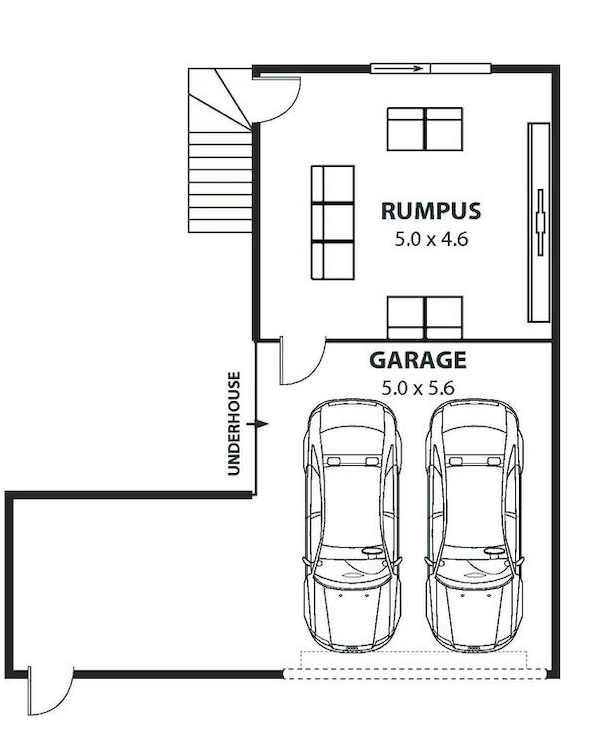

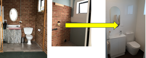

I'm planning a renovation project to transform our rumpus room on the back of our garage into a combined study and laundry room, and I could use some advice. Here's an overview of what I'm aiming to do:
Room Size: 5m x 4.6m
Plan Overview:

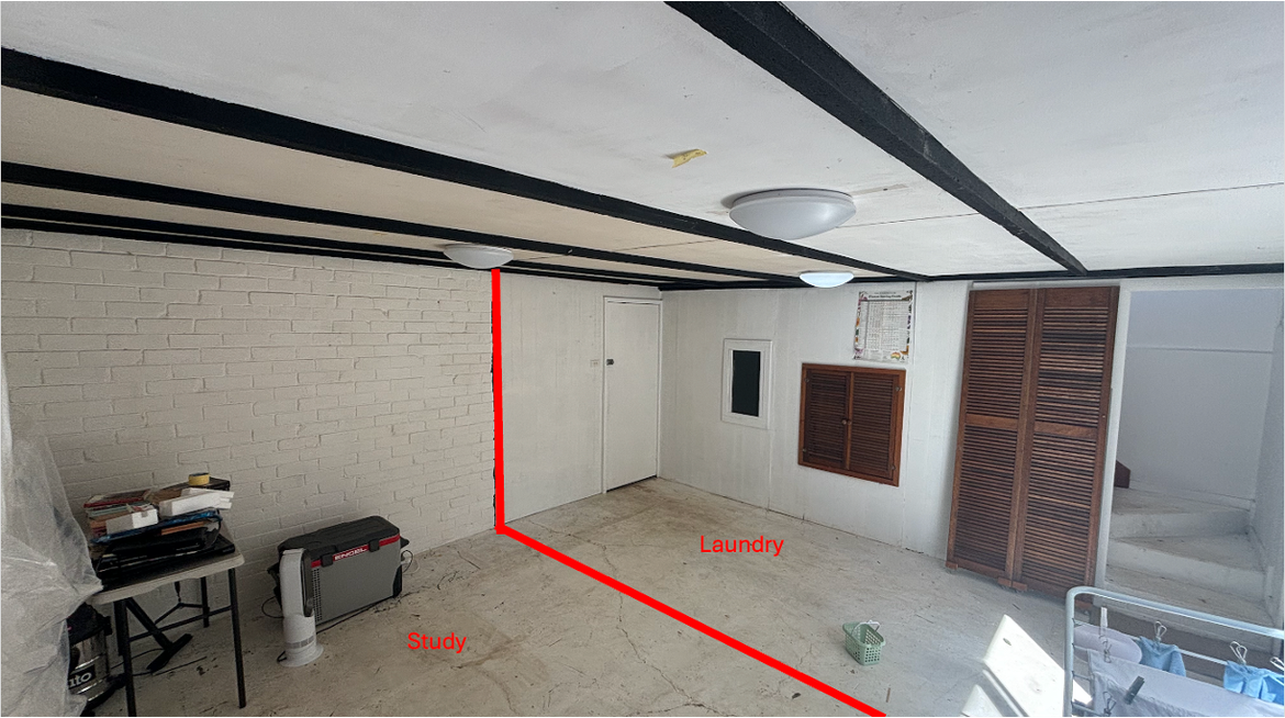

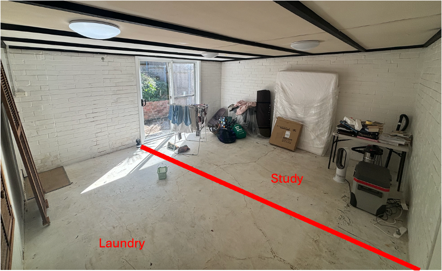

Flooring: The existing concrete floor is uneven (higher in the center). I plan to level it - I a considering a self-leveling compound and cover it with water-resistant hybrid flooring panels. Any product recommendations for these materials?

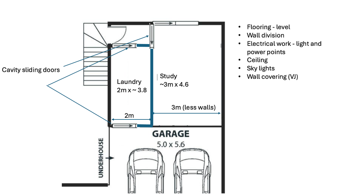

Room Division: I want to divide the space into a study and a laundry area using a permanent wall. What type of materials and insulation would you suggest for this purpose, especially to keep noise from the laundry down?
Ceiling: Planning to install a drywall ceiling that can be easily attached to the existing garage cross beams. There is some insulation already in the ceiling that was done for the rumpus and plaster covering between the beams.

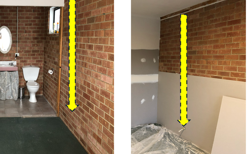

Wall Covering: I’m considering using VJ paneling for the walls. Could you recommend paneling? does anything need to go between the paneling and bricks? (the existing walls are brick)
Lighting: I plan to install recessed lighting in the ceiling with the help of an electrician. There is wiring already there to utilise.
- Doors: Cavity sliders x 3 - again open to suggestions.
Please see rough plans in the images
Thanks in advance for your help! I appreciate any advice or recommendations you can offer
