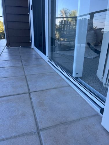

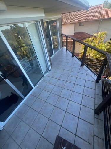

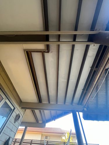

Currently, all 3 bedrooms are upstairs and lead onto a timber framed, tiled balcony that leaks badly onto the deck below at the door threshold (not VUTH). We want to enclose under this balcony so we can add more space to our kitchen below.

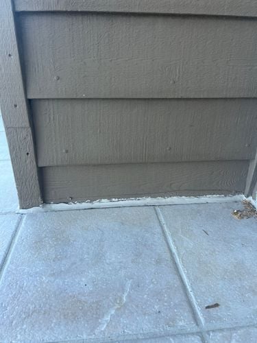

Furthermore, the balcony floor buts up (with a few mm gap) to the weatherboard cladding and is poorly sealed.

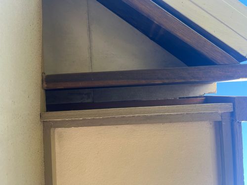

Step 1: Remove doors, demolish tiles, assess whether current fibre cement sheet can be re-purposed.

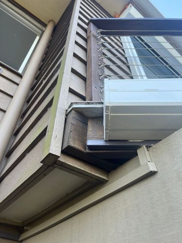

Step 2: Remove bottom 2 weatherboards around the entire perimeter and expose timber framing.

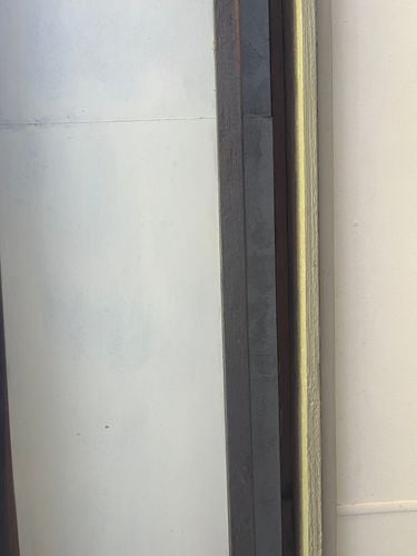

Step 3: If FC sheet isn't re-useable, replace with Scyon and butt up to the exposed timber framing. If useable, achieve the butt join to the exposed timber framing but cutting out and replacing only what is required.
Step 4: Seal / waterproof join between internal (particle board) flooring and exterior Scyon / FC flooring

Step 11: Seal cladding to floor join with Sikaflex

Below are a bunch of images and really keen to hear what I might be missing? - Thank you kindly!
