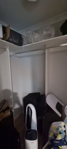

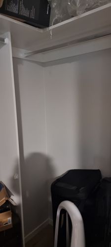

HeyI have basic walk-in wardrobes that came with the house. How do I add shelving to it as currently, all the space is for hanging?
Hi @rahatsaini,
You can use melamine-covered particle board to create new shelving. This new shelving will need to be supported in the middle with lengths of 42 x 42mm Pine between each shelf. You'll also need to attach lengths of 42 x 19mm Pine to the walls to support the edges of the sheets.
Small mending plates can be used to connect the shelves together.
If constructing the shelving from scratch seems a bit much, you might like to check out our fantastic range of wardrobe shelving that can be inserted into the space.
