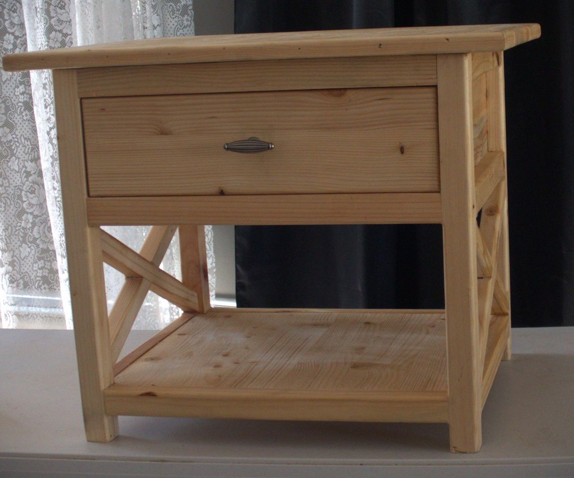

Barn bedside table, I want to build not only my furniture but also build for the community, from recycled pallets.
Materials
recycled pallets from Bunnings, metal runners, draw handle, screws, and nails for nail gun, PVA glue, and wax.
Tools
drop saw, table saw, thicknesser, router, sander, hammer, chisel, square, clamps,
Steps
Step 1
1# cut the length, 2# cut the thickness in the table saw, 3# plane it through the thicknesser, 4# join the top and bottom shelfs, 5# glue the frame together, 6# fit the cross Pices together, 7# fit and nail the bottom shelf, 8# fix the side panel for the draws,9# screw the draw runners, 10# build the draw, 11# screw the draw to the runners, 12# screw the top, 13# screw the draw front and handle, and the last step wax it.
