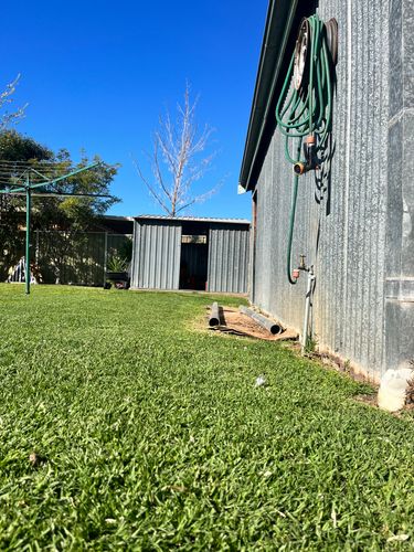

I want to build a raised garden bed against our garage (where you can see the cardboard and pipes on the ground in the attached photo). Our backyard is uneven and has some lower spots, including directly beside the shed. It's an old shed on a concrete slab, but I can see there's a good couple of inches of rust at the bottom where water has started to pool. There's about a 110-150mm drop down to the slab.
My gut feeling is that I should probably correct the drainage before installing the raised garden bed - possibly by building up the soil next to the shed to make it more even or cutting into the rise on the left of the shed, but I'm not entirely sure! Can I please get some advice on how to get started? We are also planning to install a gravel pathway straight down from the garden shed beside the garage and raised garden bed, but it would be good to at least get the foundation beside the garage right now so I can build the garden bed and get our spring veggies growing.
