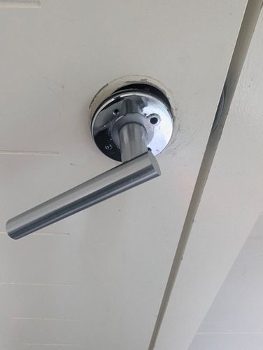

The door handle is stuck and doesn't come out. I have tried removing handles but didn't succeed.
Welcome to the Bunnings Workshop community @gul. It's brilliant to have you join us, and many thanks for your question about removing a door handle.
It looks like you've removed the screws that hold the handle together. Are there any small grub screws in any of those holes that also need to be undone? Perhaps use a torch to have a look inside them. Occasionally there might be a grub screw that needs to be undone with an Allen key.
Can you take a look down behind the cover plate and see if there is anything else connecting them? Have you tried turning the round cover plate anti-clockwise?Please let me know if you have any questions.Mitchell
