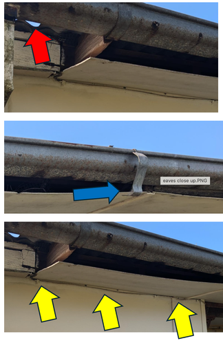

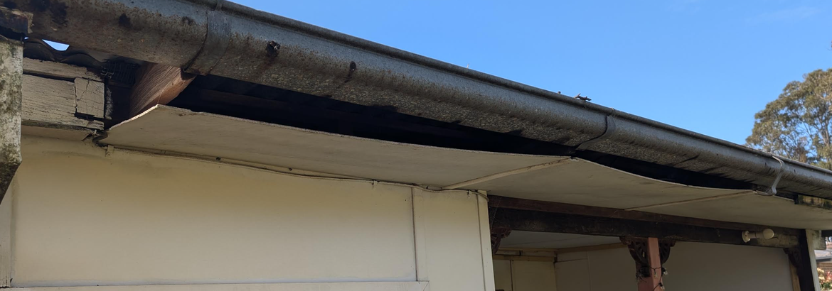

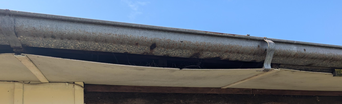

Hi all,
The eave sheeting under my roof is starting to collapse.
What would be the easiest way to fix this?
Thank you,
Wally

It looks like the eaves have been fixed directly to your roof rafters which are likely spaced at 1200mm centres. Is this correct?
If this is the case, the reason your eaves are sagging is that 4.5mm thick eave linings such as these James Hardie HardieFlex™ 2400 x 450 x 4.5mm Eaves are only designed to span 450mm between bearers (rafters) and 6mm eave sheets such as James Hardie Versilux are supposed to span 600mm.
To adequately support the eave sheets, you will likely need to add some framing between the rafters. This would involve removing the rafters and exposing the framing, which would likely damage the eave sheets, potentially making them unsuitable for reuse.
If you are looking to fix the issue conclusively, this is certainly the way to go, but if you are simply looking for a temporary repair to buy some time before a more conclusive repair, you can use Paslode 30 x 2.8mm 500g Galvanised Fibre Cement Nails to refix the sheets to the rafters.
