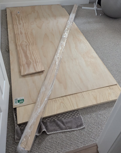

I ended up using CD panels for this, and would not recommend.
Lots and lots of filler and sanding (and filler and sanding), it's a shame Bunning's don't sell the thicker panels in BC (or higher).
Would probably follow the recommendation to use formply or mdf if I do something similar again (or source better quality plywood elsewhere).

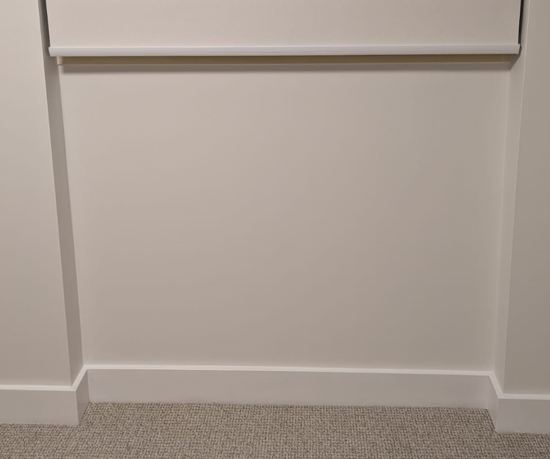

The space to be filled (which is why I needed the specific dimensions):
The specific width was to fill this space
The materials ordered (dressed pine for top/face frame, BC panel for backing, CD panel for carcass):

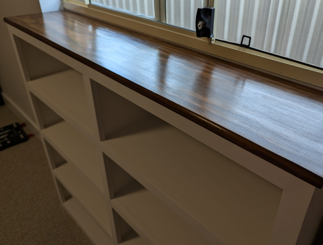

Final product front on:
Final product top down:
Final product with stained pine to match wood in the room
Afternoon @jarko
Looks good and love that bookcase top!
Hi @jarko,
The extra work of filling and sanding has certainly paid off.
It looks great!
That is a beautifully made bookshelf. The finish on the body and the top are outstanding. Can you please tell us what product you used for the cabinet top? Did you have to dilute it or did you paint it directly over the wood? Any building or finishing tips you can impart to our members would be verymuch appreciated.

The top is made of dressed pine (https://www.bunnings.com.au/285-x-19mm-2-4m-dar-pine-premium_p8401478)
@EricL I wanted the top to match an existing walnut top I have on a desk in the room, after sanding I used a stain (https://www.bunnings.com.au/cabot-s-250ml-walnut-water-based-interior-stain-250ml_p1520295) and a finish over the stain with 3 coats of poly (https://www.bunnings.com.au/cabot-s-1l-satin-water-based-cabothane-clear-polyurethane-timber-varnish_p1522384).
I used water based products even though they are more expensive, they are easier to use and cleanup for a beginner.
