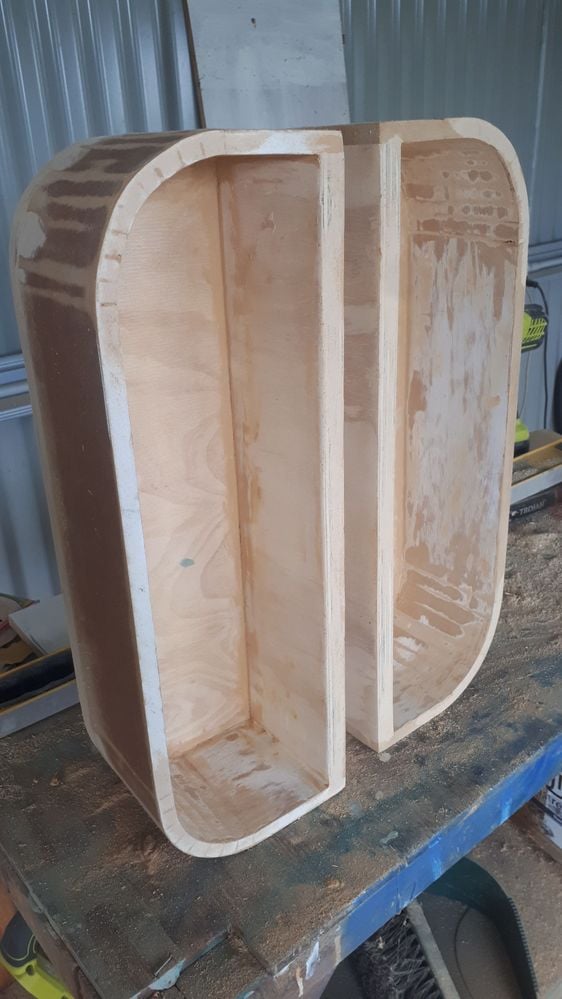

Step 2
The side bits were a bit tricky. I had to cut several notches in the MDF for it to be able to curve around the edge. By adjusting the depth gauge on my circular saw I was able to carefully make these cuts.
Once I was happy with the shape, I was just a matter of screwing them in place, putty the small gaps and sand.

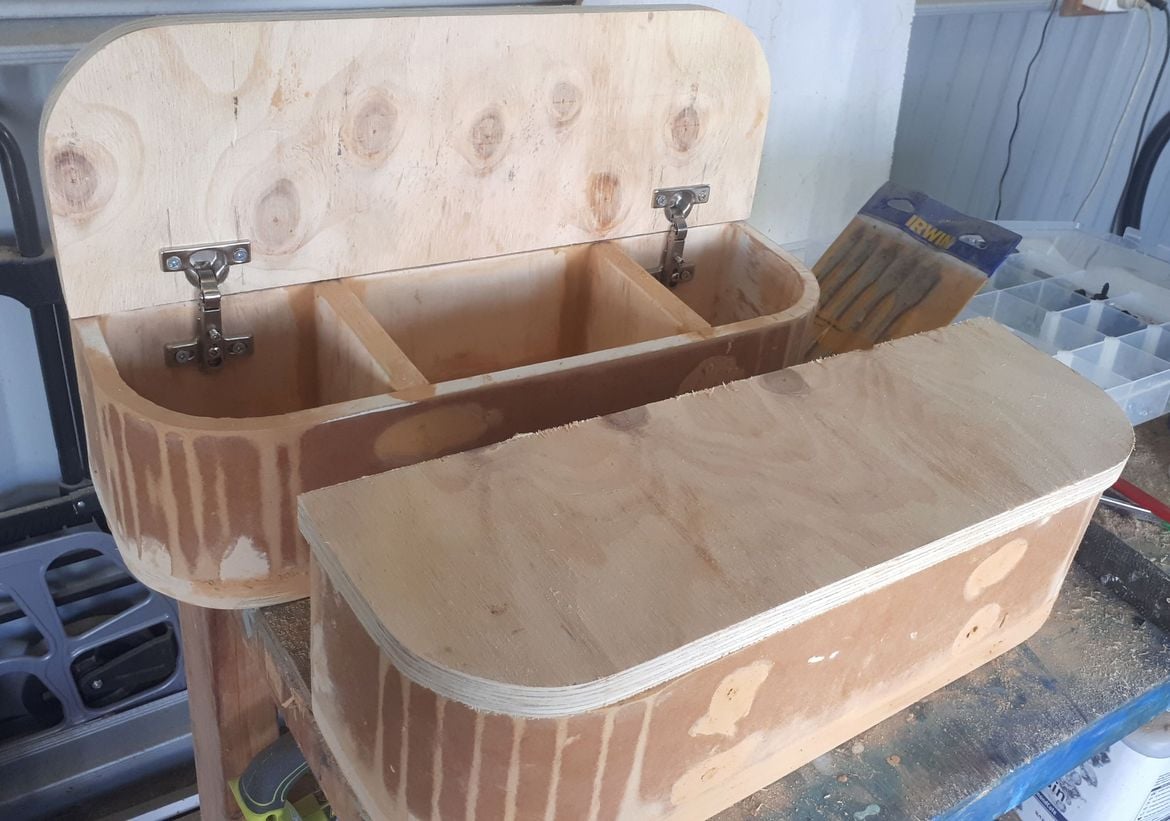

Step 3
Next I added the shelves. I took one of the young fellas' game cases to size the shelves off. I wanted the shelves to be practical as well as fun.
I added cabinet hinges for the doors. I could have easily used regular hinges but this way the doors held themselves closed.

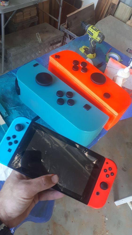

I ended up using spray paint for the colours because it was the closest match to the console colours.
The buttons were cut out of MDF, pre-painted, and either glued or screwed into place. The joysticks have a smaller piece underneath to lift them off the door and give them depth.

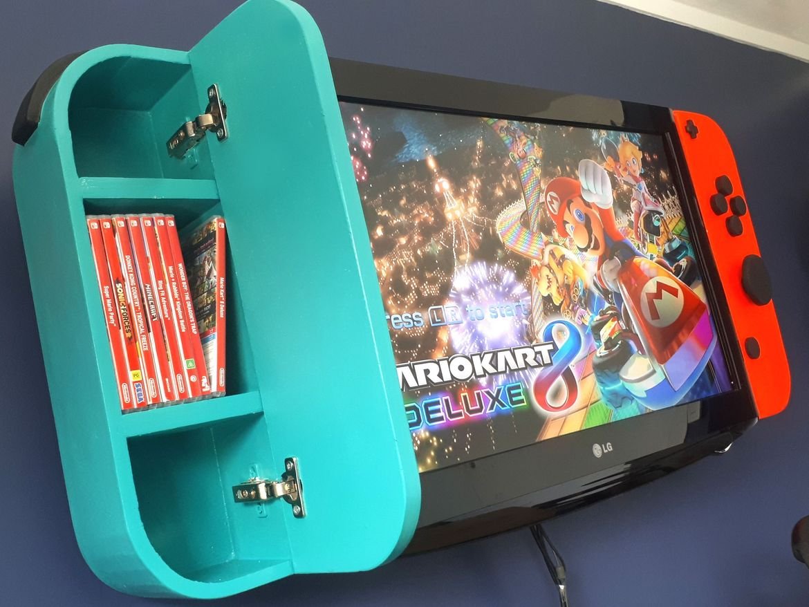

Step 5
I attached the TV to the side pieces with 67mm x 19mm Pine. Screwing the Pine to the TV using the standard screw holes on the back of the TV and extra long screws and washers.
Then I attached the Pine to the TV wall bracket, and here you have it!
