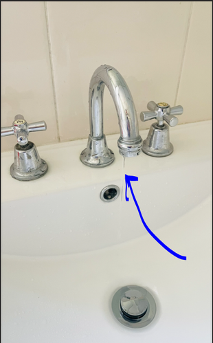

I am having shower tap leakage.

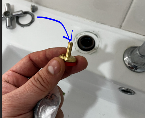

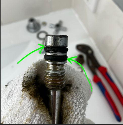

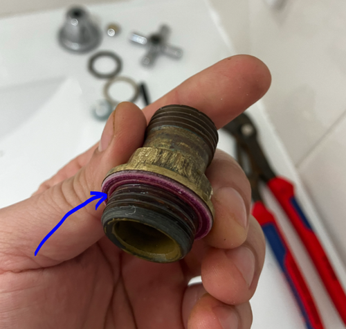

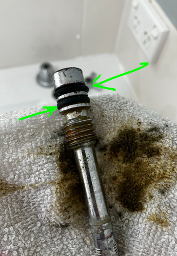

I got it sorted out this time by replacing some internal parts. I am putting new washers or taps later in the future. Hence, for now, I wanted to work it out. I used Lubricant as well.
Changed them on both sides :
Changed this too:
Put this new :
