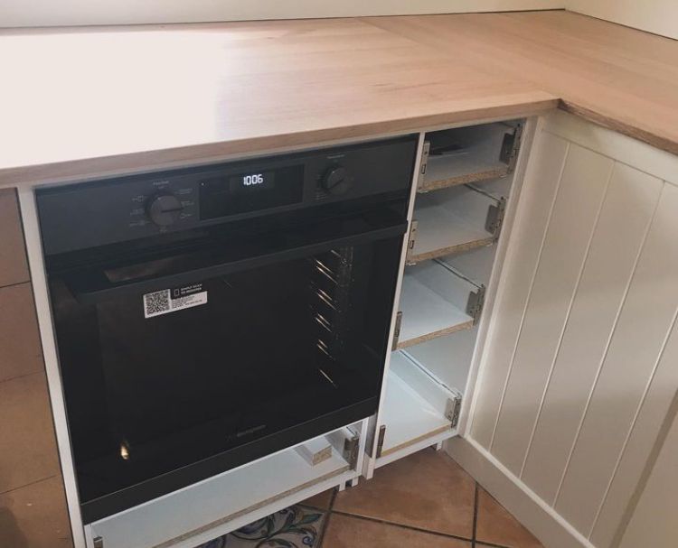

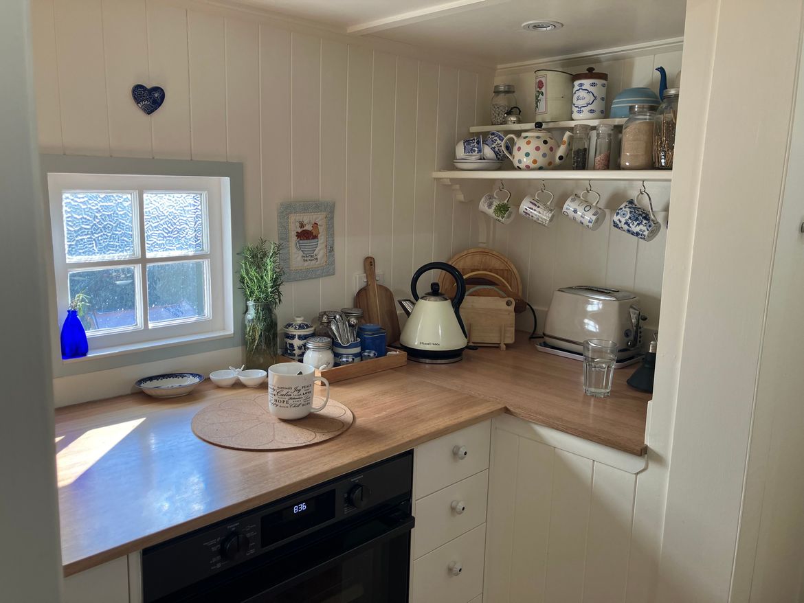

Most of my work area is enclosed in the old stove bay. Needing to replace the oven I decided to make the area more functional, replacing deep narrow cupboards with drawers, and the plywood benchtop with Tasmanian Oak.
It’s working beautifully now! I chose not to have a cooktop at this point but have a single plug in induction burner which I’m finding better than I expected.

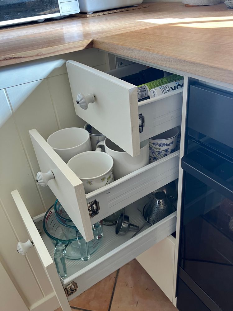

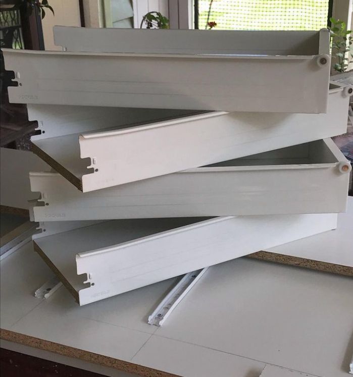

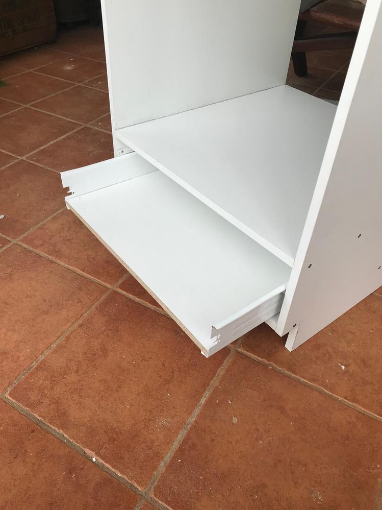

Made the drawer and oven units. There is nothing square in this kitchen! I chose not to use under cupboard legs as I’m using the space to store flat baking trays and such (eventually in box drawers). This is where I learned how important it is to cut square edges, so I made a jig to line the handsaw up against ,which thankfully worked well because the next step needed it.

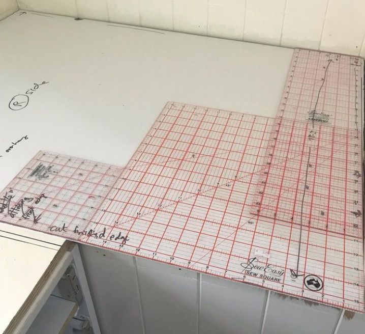

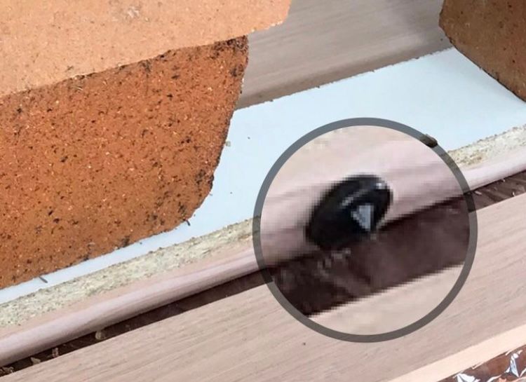

Using corflute I made templates for the benchtops. I decided to leave the existing painted ply in place (filling in the cooktop top hole with a piece of scrap melamine and a bit of swearing), for strength and hopefully a bit of stability as the panels are only 19mm thick. It seems to have worked well. Because of the tightness of the space I couldn’t dowel join the two cross seams, so used the super strong gorilla glue and crossed my fingers. It’s been there since Easter with no problems. I used wooden pegs around the edge to hold together and allow a bit of expansion room.

I used 12mm x 90mm thick pine strips to finish the edges. The cupboard fronts are painted MDF. One day I might play with them a bit more to give them a panelled look but there’s a lot more kitchen beyond this area to finish first. The drawer beneath the oven was painted black to match the oven with a long bunnings drawer handle similar to the oven handle.

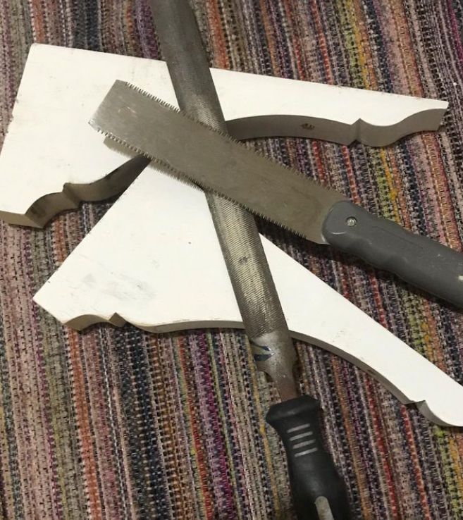

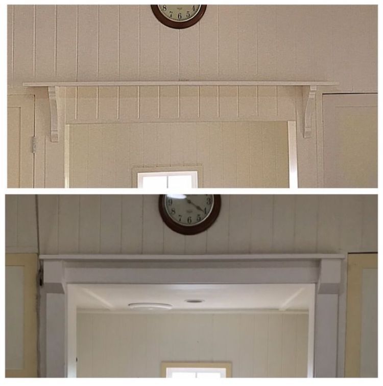

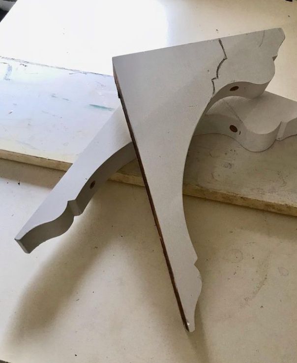

The ‘frame’ of this area was improved using two veranda brackets for the mantle, modified to fit, which I’ve also used to hold the shelves inside the area.

And happily in use!
