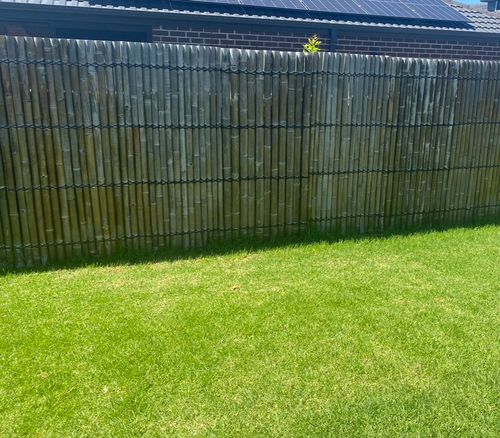

Hi I am seeking to apply sealer/color on bamboo fence panels.
kindly suggest the best colour/sealer brand and can I paint with the spray gun or I have to use brush.

Hi @Mo2,
Unfortunately, bamboo is quite a challenging material to work with when it comes to applying sealers or stains, as there aren't any coatings that specifically state they are suitable for bamboo. Bamboo has a natural waxy coating that makes it resistant to most treatments, preventing stains or sealers from penetrating effectively.
Given the wear and greying of your panels, applying a coating may result in an uneven, patchy finish, especially where some areas may still have their natural oils intact while others are more weathered. Because of this, I can't recommend any particular product for bamboo.
You might consider lightly sanding the surface to remove some of the grey and worn areas, though even then, results can vary. It's always a good idea to test on a small, inconspicuous area first to see how the material responds.
