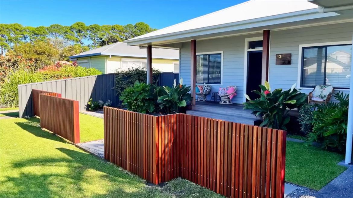

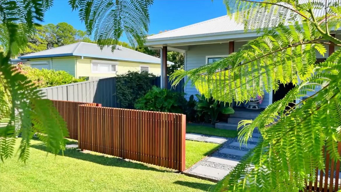

G'day Matkai.....l think it all depends on the look you're after and l do agree with setting the posts into post stirrups rather than putting the post in the ground. However, If you do decide to put a post in the ground I'd go for an ironbark post and coat the piece that goes into the ground with bitumen paint to help preserve the part of the post that is in the ground. Iron bark is good for at least 25 years in the ground and 45 years above the ground which is pretty impressive. I built my front fence from iron bark and it looks fantastic!
I'll attach a photo of the fence so you can see what l mean.
If you go for the stirrup method, consider a High Wind Rated Stirrup especially if the trellis fence is free standing......something like this https://www.bunnings.com.au/pryda-post-anchor-high-wind-450-x-90mm-m12_p1120037
