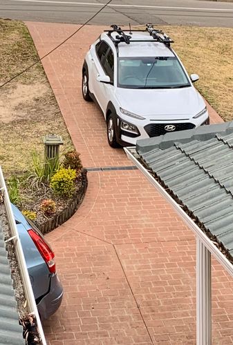

I have a long patterned concrete driveway over 15m and slopes away from the road. It needs resealing. I have wet and forget it and pressure cleaned now what sealant should I use?
Welcome to the Bunnings Workshop community @Robbondster. It's wonderful to have you join us, and many thanks for your question about sealing patterned concrete.
For resealing your driveway, I recommend using Dulux Avista 10L Semi Gloss General Purpose Concrete Sealer, which is ideal for stamped and stencilled coloured concrete surfaces. The sealer will give your driveway a fresh finish and help protect it from the elements. Before applying, it's important to test whether the existing sealer can be overcoated. You can find the necessary testing steps and detailed application instructions in the user guide.
Once you've confirmed compatibility, you can apply the sealer using a roller or sprayer. Ensure the surface is clean and dry, and work on a day with mild weather for the best results.
