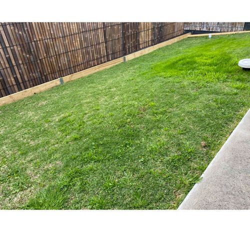

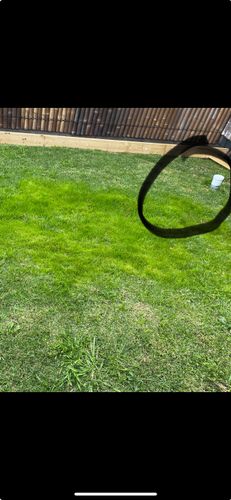

I am planning to level the back yard. Please guide and give suggestions where you feel like
Installing 2 layers of 200X50 mm timber sleepers and adjoining them with C and H post ( I will take off the existing post and install 0.9m post so it can accommodate one more sleeper)
Fill the area with garden mix
layout the natural turf
Q 1. Do I have to color the sleeper before installation for longevity?
Q 2 . The total height of the retaining wall is 400mm. Do I need to have drainage?
anything else I have to consider before starting the project?
Access to backyard is narrow and I have to use wheelbarrow to move the soil.
