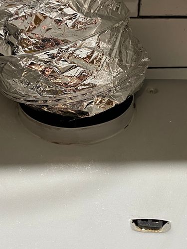

I am in the process of installing my range hood but I am not sure how to attach the duct to the range hood. I tried duct tape but it does not seem to hold well. Is there an alternative product?
Hello @ewan
Thanks for sharing your question about the installation of your rangehood. I suggest using the Pacific Air 150mm Stainless Steel Worm Clamp - 2 Pack. This will clamp the ducting to the neck of the rangehood. Please note that the clamp comes in several sizes so please double check the size of the neck of your rangehood before purchasing the clamp.
