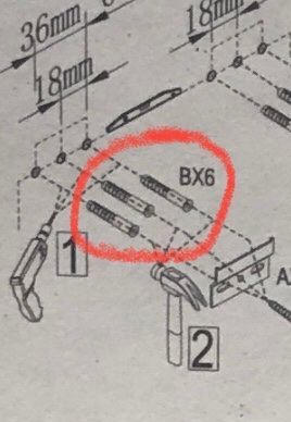

Hi there, quick question - I’m installing the Mondella Rococo wall hung vanity I/N: 0184819 and the manual specifies to use wall plugs:
I’m fixing it to a stud wall though, I’m assuming that I won’t need to use plugs for that?
Thanks,
Tom
Hello @tom138
Yes, you don't need to use plugs if you are mounting the vanity onto a timber stud. My best advice is to drill pilot holes to prevent splitting timber stud.
