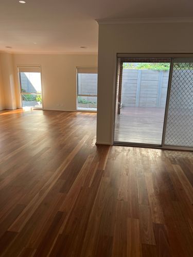

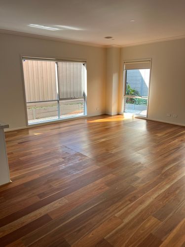

I recently received the keys to my house. The timber flooring has some glossy marks at high traffic areas and where furniture used to be. When the sun hits the marks are very obvious. My friend recommended the Feast Watson's line of products for a simple DIY fix.
I am a novice in DIY but would like to learn to be more handy. I have compiled a shopping list to undertake this project. Noting that I have nothing in the house, so I am buying everything that is required. Please have a look at my list and provide your opinion if this is the correct way forward; and is there anything I should add to the list :

Welcome to the Bunnings Workshop community @PL59. It's wonderful to have you join us, and many thanks for your question about restoring flooring.First, can I confirm that these are natural hardwood and not Hybrid or laminate flooring? If they are hardwood, then you've selected the appropriate products.

We really need to determine what the flooring is @PL59. Laminate typically repeats the boards and I'm not really seeing that. Laminate often has like 5-7 different boards that you stagger around so two of the same are not next to each other.
The best way to check it to try and find somewhere where the edge of the board is exposed. Often you'll be able to see the timber end grain. Have a look in cupboards where the finishing might not have been terrific, they often leave gaps there.
If it is laminate, then you'd use Cabot's 1L Floor Clean and then Cabots 1L Laminate Floor Restore.
