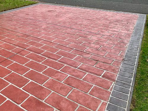

We have a stenciled concrete driveway and paths that, after several years, started to look weathered and in need of maintenance. To refresh its appearance and restore some of the faded areas, we decided to seal it and bring it back to life. We followed the tips from a previous post, and the whole process took about 3-4 days.
Cleaning the concrete surface was the most time-consuming part, as it involved multiple stages, and drying times at least 24 hrs. After cleaning, we applied the sealer. When the concrete was originally laid and stenciled, the contractor added coloured pigments to achieve the desired look. However, some of the colour had faded over time, so we chose to apply a tinted sealer to areas like the borders to refresh them. After our mini-restoration, the driveway looks great and the sealant should last for at least 3-4 years depending on the use and weather.

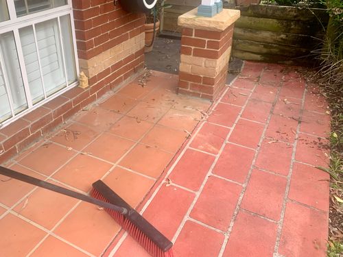

Cleaning the driveway Stage 1
Inspect the area and broom as much debris off as possible; use the wide outdoor brooms as they are wider and have stiffer bristles. You can use a blower vac as well. Make sure all leaves and debris are removed from the driveway and paths.

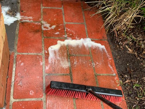

Cleaning the driveway Stage 2

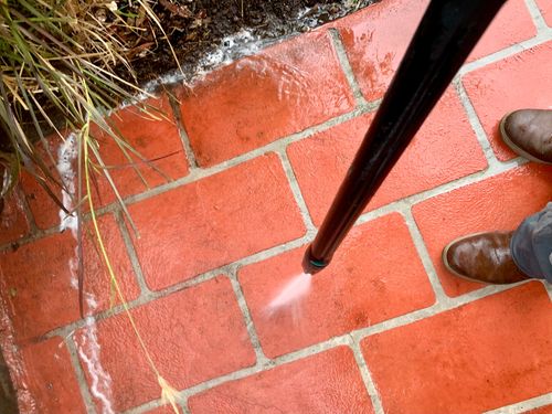

Wet the area with water using a garden hose and add in the driveway cleaner. Strongly broom over the area to remove ingrain dirt and marks off the concrete. Once this is completed, the next step is to pressure wash the concrete surface. This is important to do as the Gerni or similar will remove all the surface contaminants. Your concrete is now ready to seal.

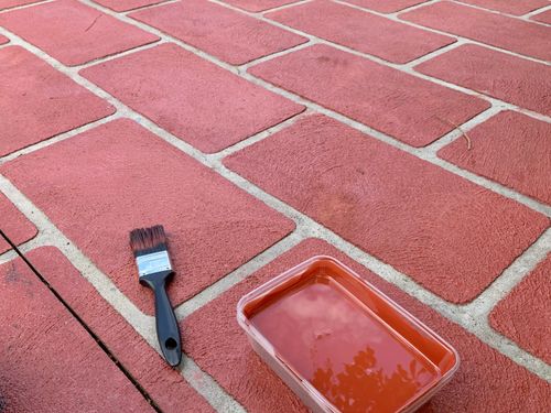

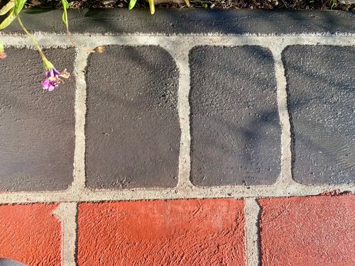

Restoring faded areas with a tinted sealant

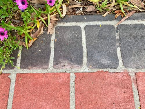

Most stenciled concrete surfaces are coloured, and this is achieved by adding pigments to the concrete surface. Our driveway, like most others, has a border which was faded over time. We restored this area by painting over the stenciled border using a tinted sealant. We also restored some of the stenciled patterns in the main driveway using a matching tint. Leave to dry for 24 hrs.

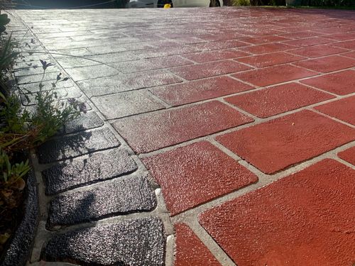

Applying the clear sealant
In the final step, a clear sealant is applied to the entire surface of the stenciled concrete. Begin by blowing off any dirt and debris, then use a roller to apply a thin, even coat of sealant. It's important to work methodically, covering the surface in a consistent pattern.
Avoid the temptation to apply too much sealant at once—this can cause bubbles to form, as I learned firsthand. Applying multiple thin layers is far more effective than a single thick coat. Let the first layer dry for about two hours, then apply additional coats. We did two coats.

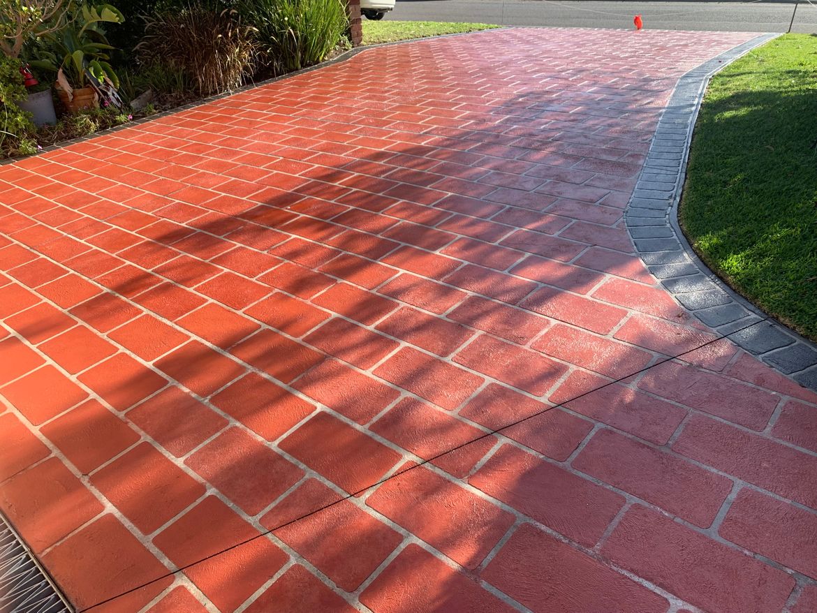

All done:-)

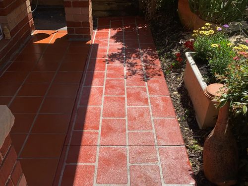

Restoring the borders made it look like new
Sealed paths

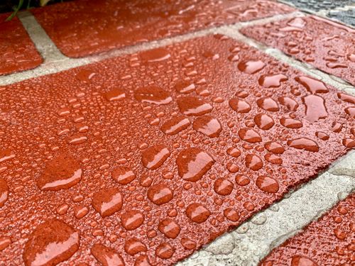

Water should bead on the surface
