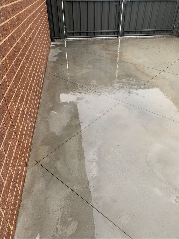

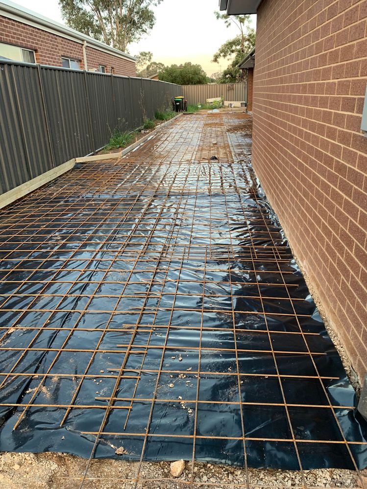

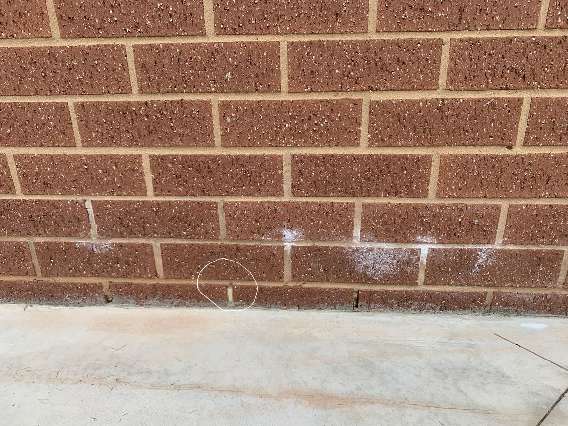

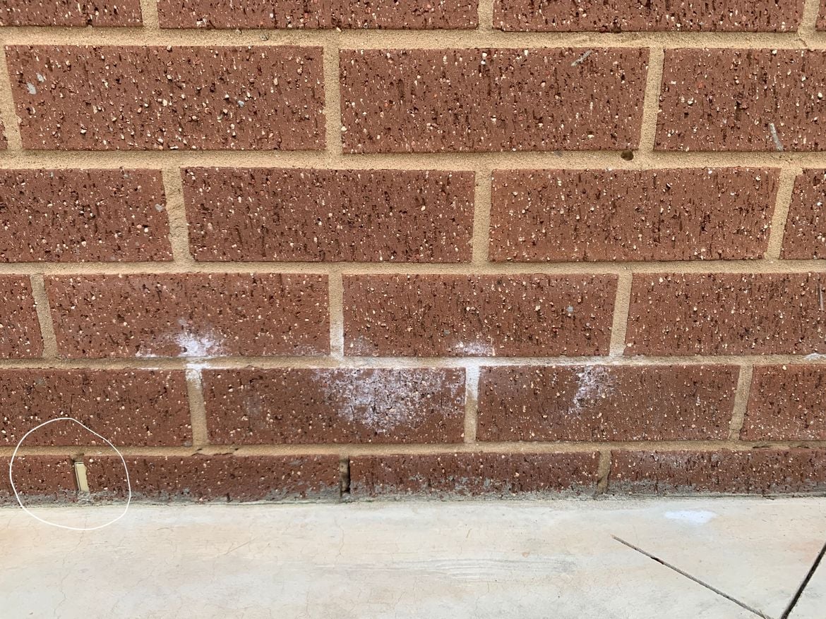

External garage wall weep holes partially covered by side concrete works & when it rains water flowing towards the brick wall this causing efflorescence. Can I completely seal the partially weep holes and create new one bit above? if so how to create them?
what to prevent water flowing toward the wall?
