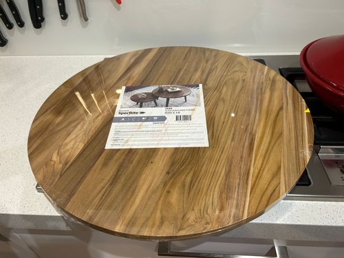

I am wondering if I can use the Teak Fj Glulam panel as a chopping board. I am wondering if the glue is food safe? I can see that it says class A glue but can only see that, that is for weathering. Advice would be greatly appreciated. Lisa

When we've had similar questions about other Specrite panels, the advice has been to sand them back to bare timber and then apply a food-safe oil such as Feast Watson 250ml Kitchen Timber Oil.

thank you for that. I just wasn’t sure about the glue that holds the panels together. regards Lisa

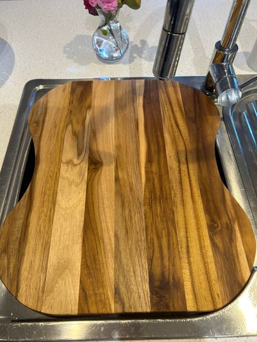

It sounds like an interesting project, please don't forget to post a photo update once you've made the chopping board. I also suggest having a look at this amazing cutting board project - Cutting boards by @JoeAzza.
Here is the finished board replacing a very tired and split one. Out with the old in with the repurposed, finished with grapeseed oil.
Hi @Lisar , the chopping board I made was already glue together, I also wasn’t sure if the glue was food safe, so I recut the joins of the timber , and replanned each side then re glued with food safe glue, Titebond 3.
