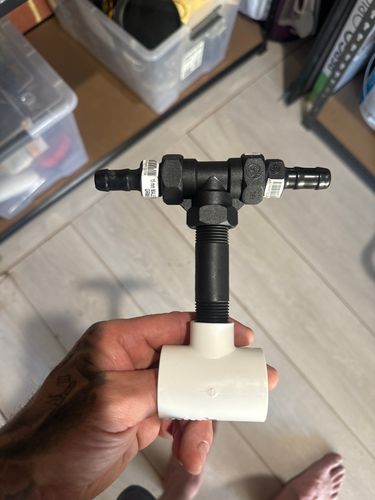

Gday so I’m about to plant hedge trees along our verge, now I already have Retic for the lawn which is 25mm pvc pipe.
I was thinking about taping into the pvc with a facet t piece, then a couple fittings and then run that into 13mm black poly to run along the hedge trees for there Retic.
Will this work and not blow of the black poly ( I will use hose clamps to hopefully eliminate this ) the pressure is reasonable and I’m already running 6 pop up sprinklers on that run.
also what little sprinklers would you suggest screwing into the black poly for the hedge plants?
picture attached is what I currently had in mind then the black poly running left and right, but I’m not 100% sure.
happy to hear any suggestions.
