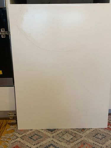

It was torn and tried to glue it back but there’s gap visible, how do I fix the gaps to blend it to the original material?
Hello @clarissa0990
Welcome to the Bunnings Workshop community. It's wonderful to have you join us, and thanks for sharing you question about fixing your cupboard door.
When the sealed vacum laminate doors are compromised it's often impossible to repair. Only if you were lucky or very skilled would you be able to join the pieces together without the break being noticed. Because it is a front door any makeshift repair applied would be very noticeable.
I suggest bringing your door to your closest store and speaking to the in-store kitchen specialist and asking them if it is possible to use a custom ordered panel to replace your existing door. If it is, the kitchen specialist will make a quote for the door or at least offer an alternative on what you can use to replace your door.
