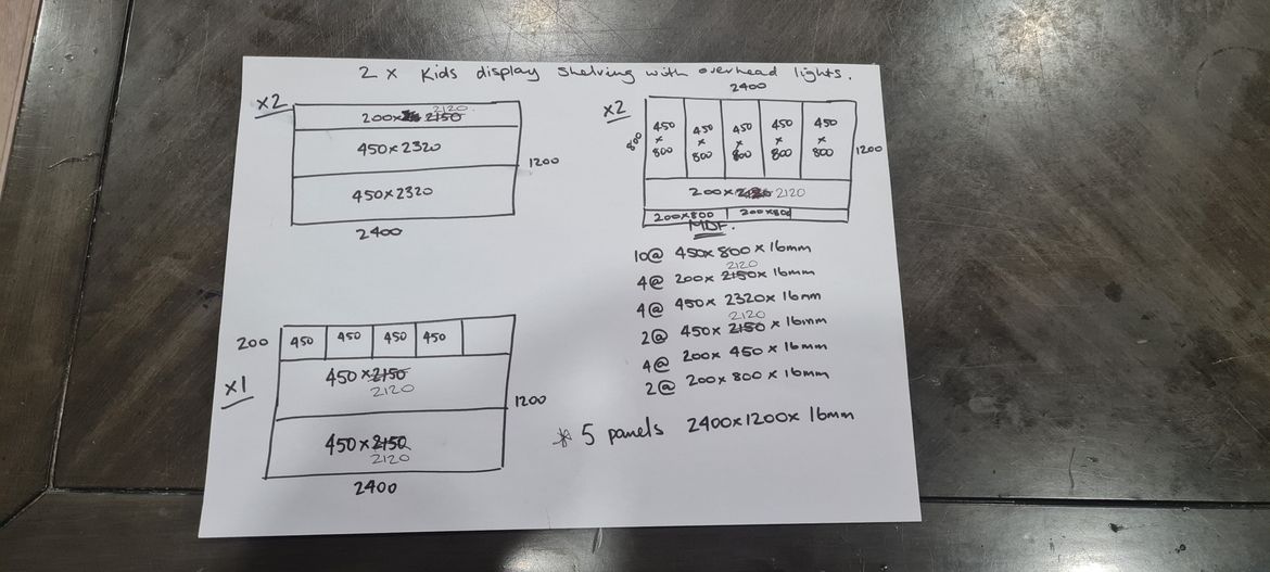

Step 1

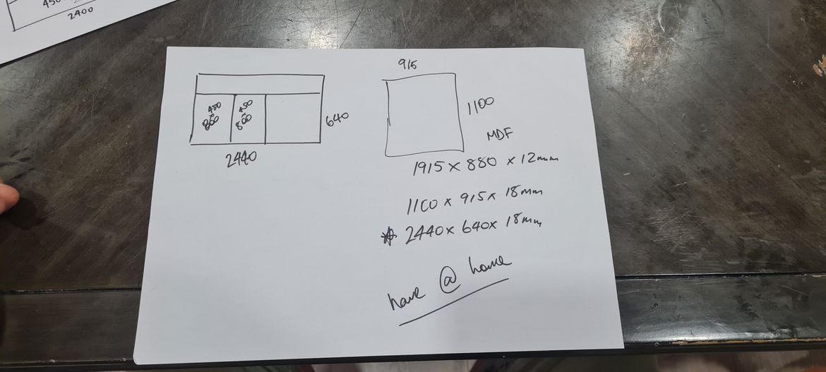

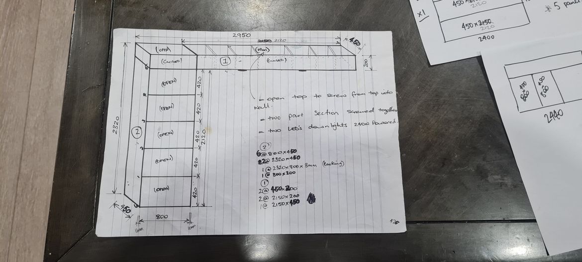

Step one was to measure and draw up the plans and work out how many sheets of MDF we required for the each room.

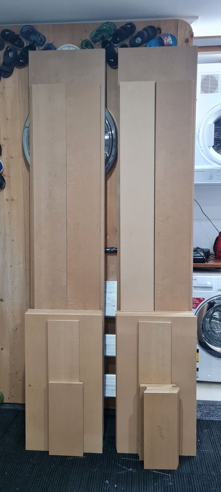

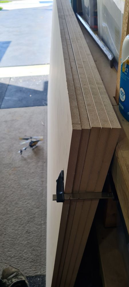

Started to cut the MDF to the measurements we had drawn up, so we had all the cut pieces required ready to assemble.

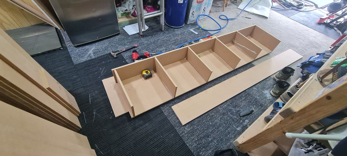

Started to assemble in the garage the first bedroom used glue to glue up all the required sections. Used the air compressor with brad nailer to fix the shelving units to the backing and sides. With a set square to ensure all the levels are even. Putty all brad nails. Sanded after putty dried with 240g Orbital.

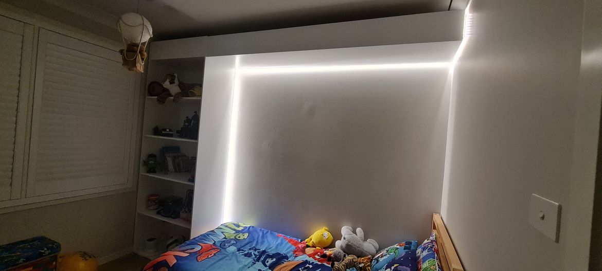

Step 6

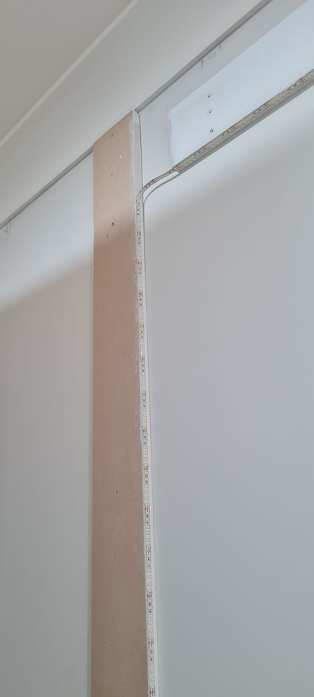

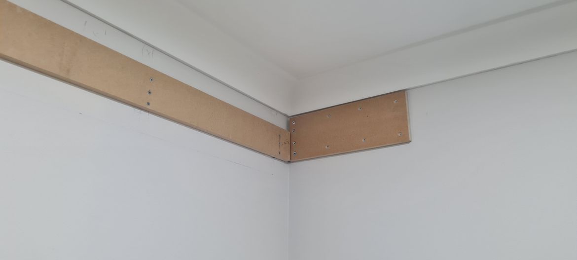

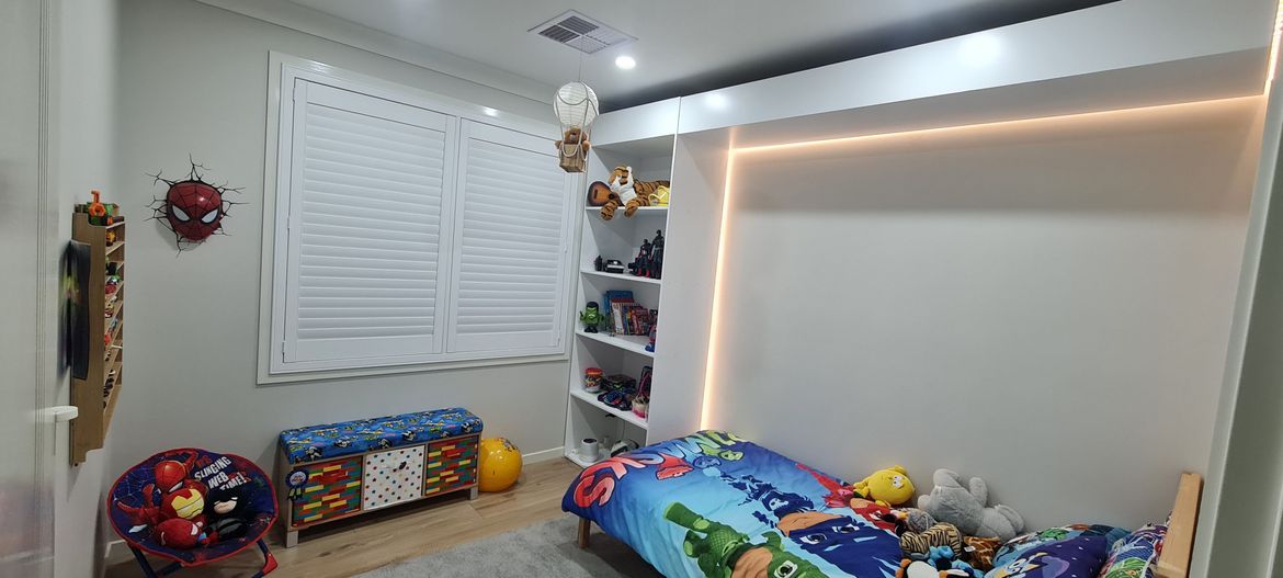

Measured, cut and installed timber battens on the upright of the wall to timber studs, we used the french cleat method. Used 100mm wide onto the wall and 50mm onto the back of the bulk head. Then install the RGB LED lighting trip to the edge. We recessed the LED back 70mm from the end finished size off the units to give a hallow glow once everything was installed
turned on.
![20230521_130545[1].jpg 20230521_130545[1].jpg](https://us.v-cdn.net/6038643/uploads/migrated-attachments/435bc5072b960d2e7333473ea445572f.jpg)
![20230514_174911[1].jpg 20230514_174911[1].jpg](https://us.v-cdn.net/6038643/uploads/migrated-attachments/31500cabecb788ec64527d448a23ffc8.jpg)
Step 7

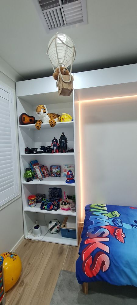

Installed the shelving units against the battens with screws and levelled (did not take pictures during these steps)
Installed the bulk head ono the french cleat onto the wall. Screwed off the bulk head on either side to give extra support.
Step 8

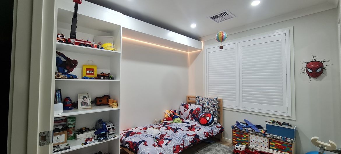

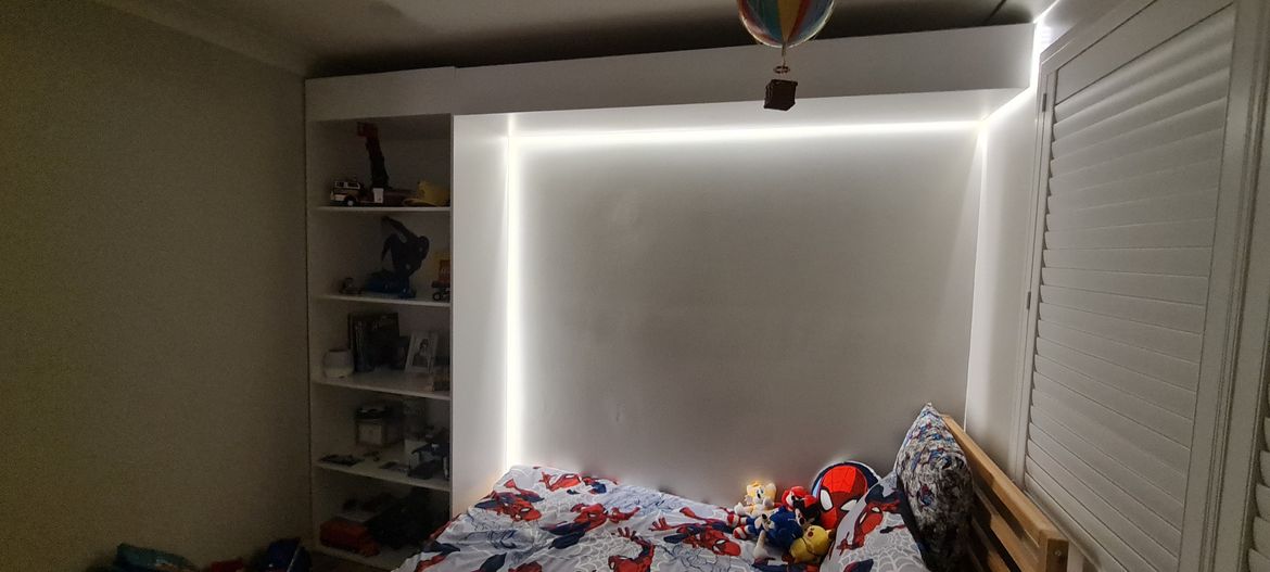

The final stage touch up any paint where required and final stage of setting up their decor in their rooms.
