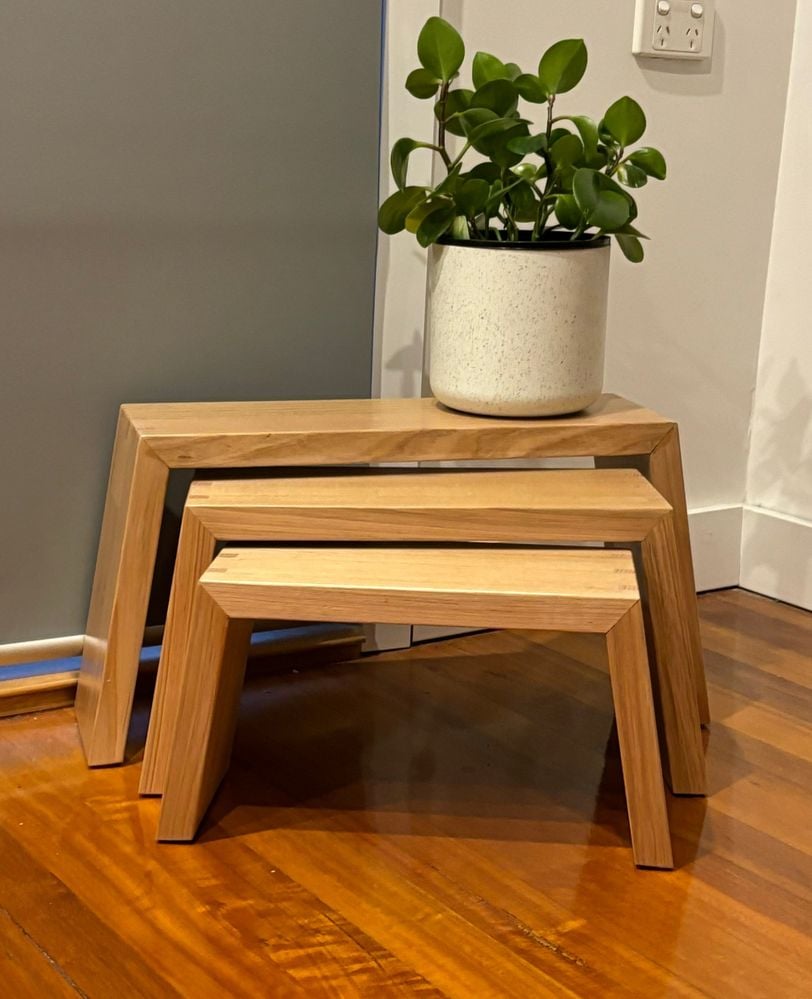

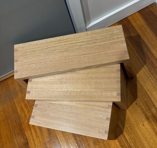

A nest of three tables made from Tasmanian Oak offcuts.
The project
I had these small off-cut timber boards that were destined for firewood. I was going to make chopping boards out of them, however, I wasn’t sure of the type of glue was used to laminate them together, so I decide to make this set of planter stands. I got the idea from the internet. I used Tasmanian Oak. This project took me six days to complete.

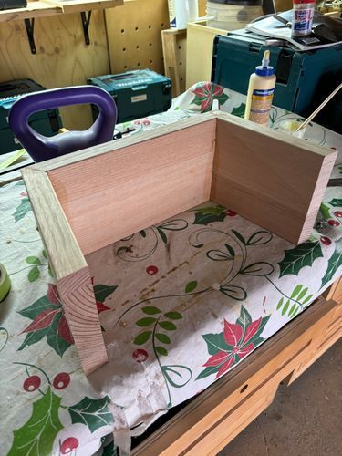

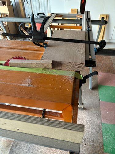

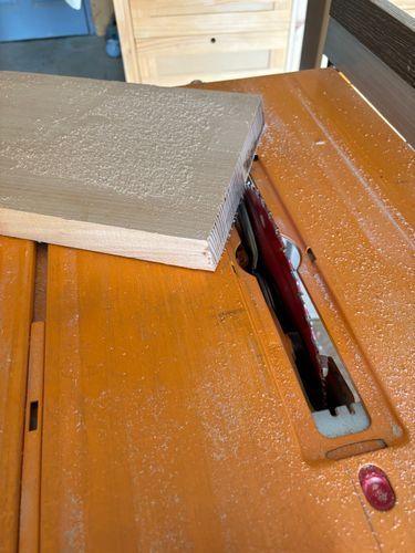

Cut angles on each board on a saw table.
Step 2

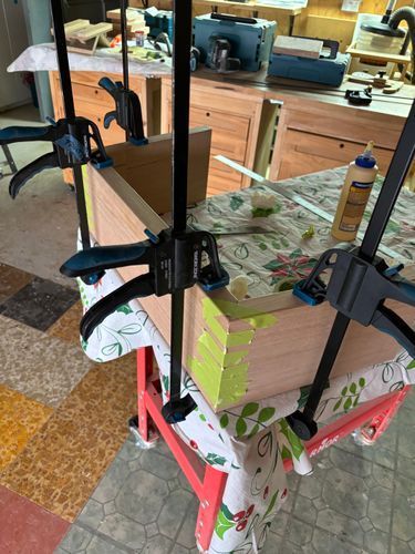

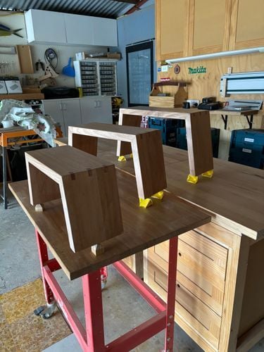

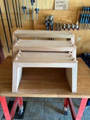

Glue up and clamp together for two of the stands. For the third stand I used superglue with a spray accelerator and the wood glue. This worked well: no clamping required.
No clamps used for this one, just super glue and wood glue.
Step 3

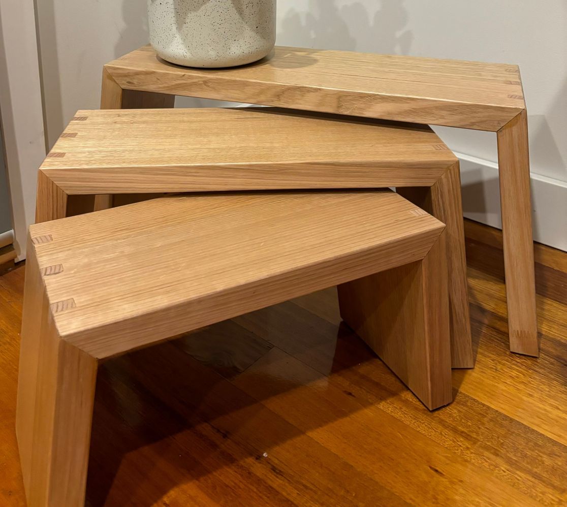

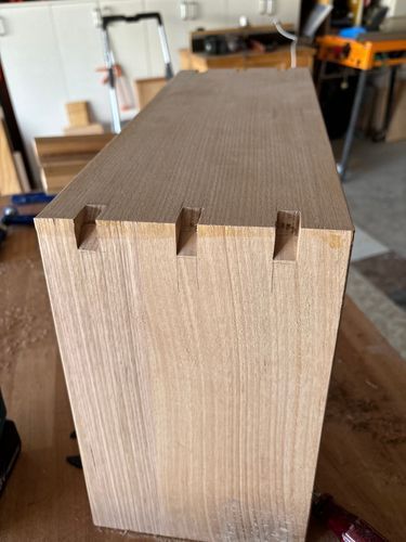

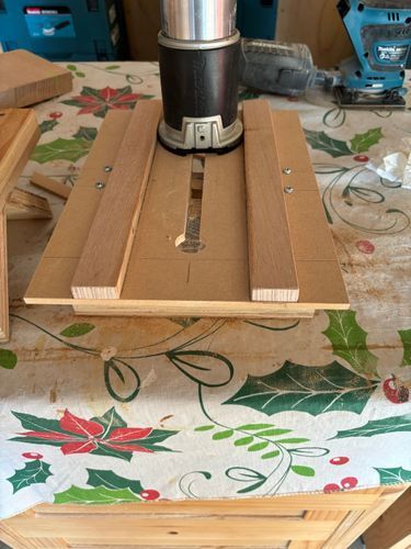

Make up spline jig and cut and glue splines.
Step 4

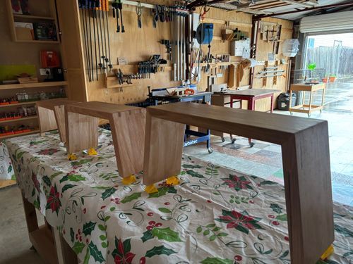

Sand and paint. I used water based clear varnish, applied with a piece off cut sponge (no brush marks).
