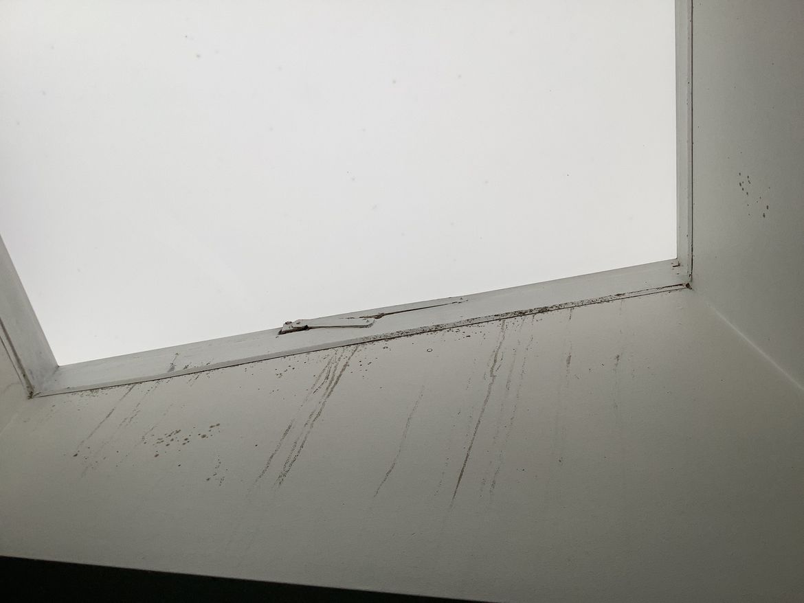

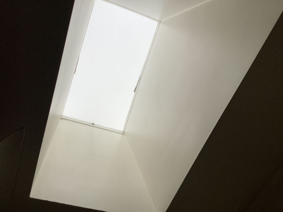

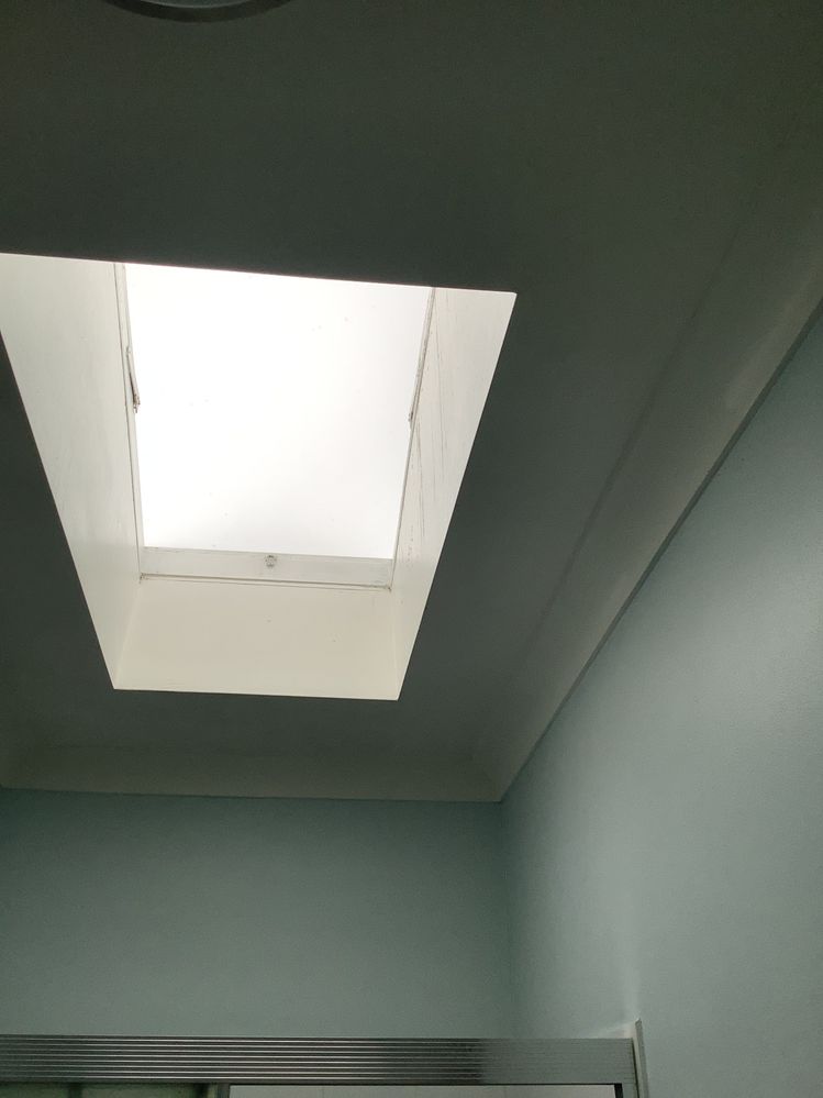

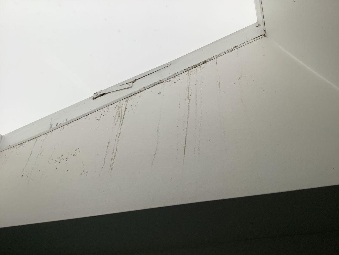

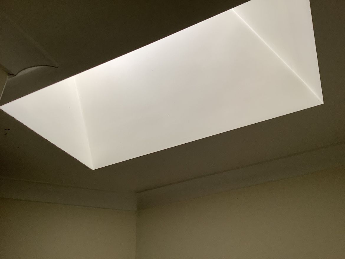

I have “older style” skylights in my ensuite bathroom and laundry that are causing ongoing issues. Originally I would notice leaves and debris in my shower and realised they were getting through gaps between the skylight and roof. No sealant or flashing tape was used when it was installed. So a few years ago I got up there and using sealant closed up all the gap between the frame and roof.
Now with a lack of ventilation mould regularly occurs, every 6 months or so I get up there and clean it. I’ve used vinegar solution, bleach and D-Mould (mouldicide) but it always returns. In winter I see a lot of condensation on the inside of the skylight, which I suspect is a major cause of this issue.
I’m interested in closing it off and turning it into a modern style “sun tunnel” but can’t find any info others doing the same?
I thought firstly I need to replace my roof mounted frosted skylight domes with a clear ( as UV helps kill mould).
Then I clean and paint the tunnel area (which is constructed of plywood boards) with mould blocker and possibly even install silver sark extra R value sheets? Lastly I close off the bottom with water-proof plasterboard and cut out a section to install a ceiling diffuser.
I think this would solve my mould issue and better insulate my house. I can see these items are available at Bunnings, any advice you can provide on this project would be greatly appreciated.
