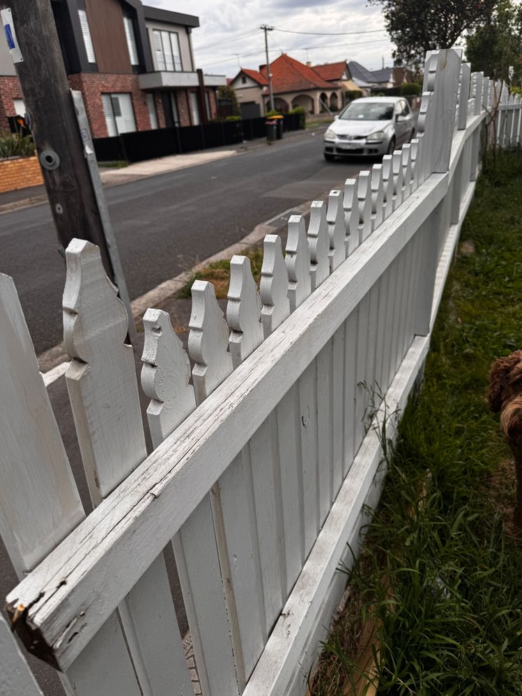

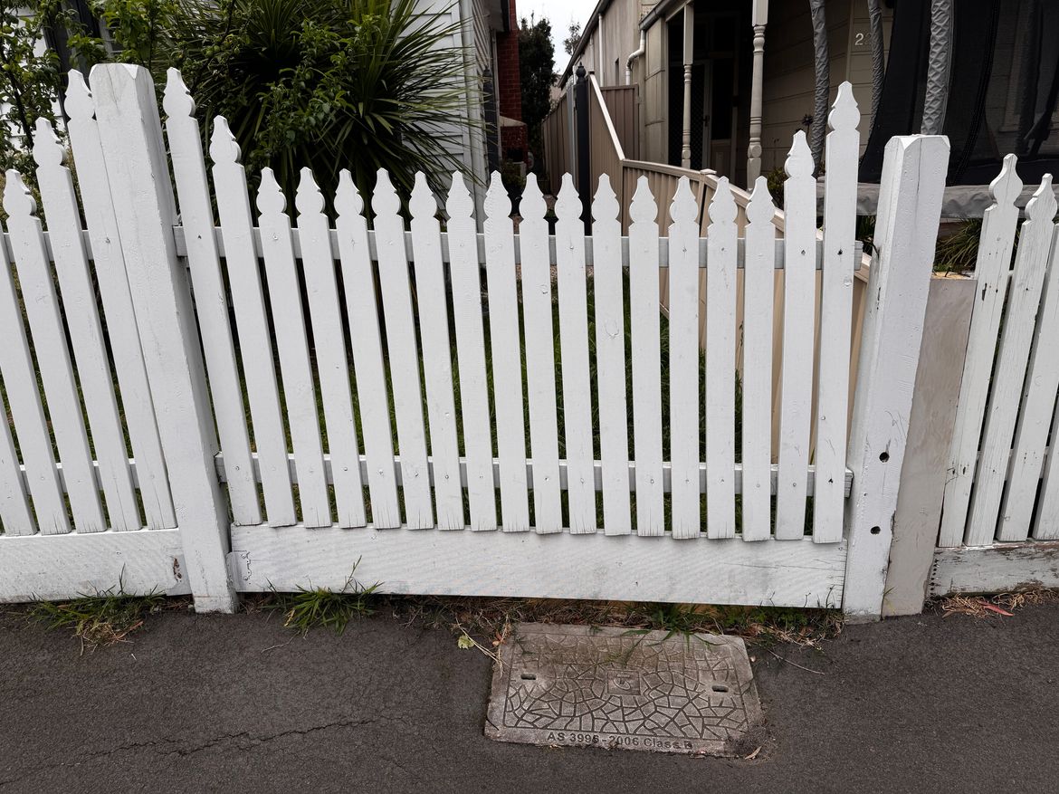

The end section of my front garden fence is over a sink hole and needs repair.

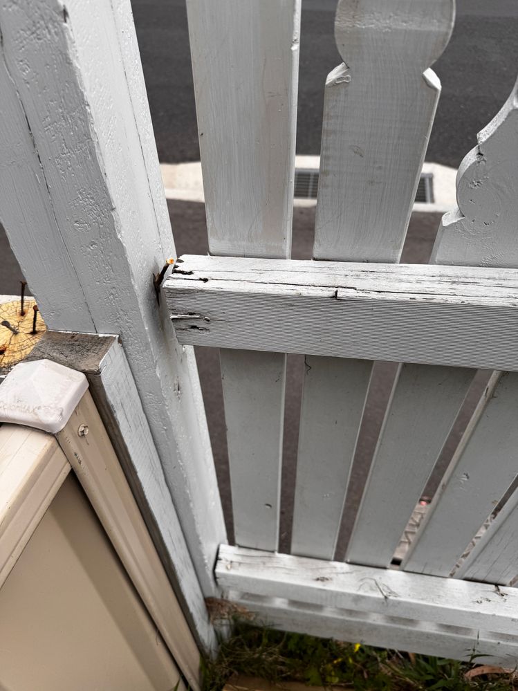

Here's the back of the fence showing the rail having come off the post nearest in the pic.
Rail broken off post

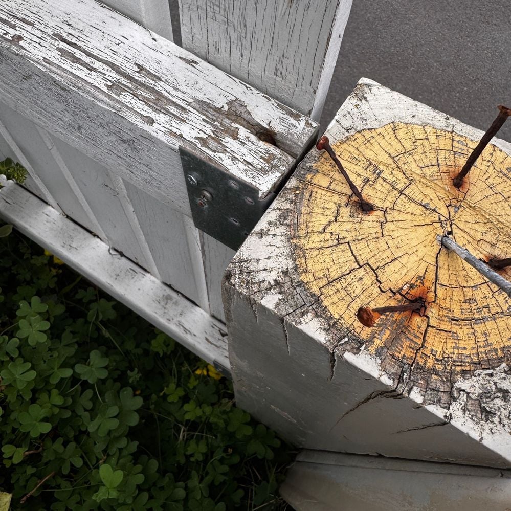

4 - Buy brackets similar to below to re-inforce rails in to the posts
5 - Attach brackets to posts and fix on rails in new position
6 - Screw on pickets to rails.
Questions/concerns:

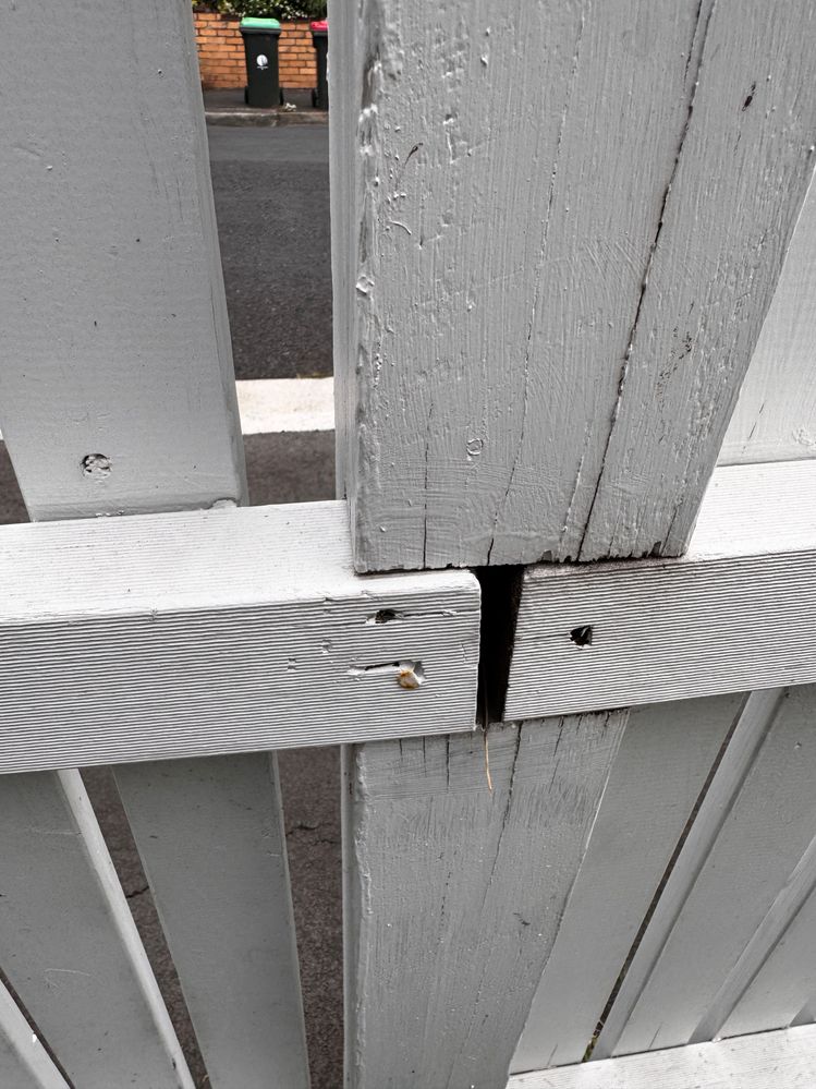

1 - I am concerned about the rail attached at an angle from post to post as it won't be attached plumb, but I have no way of re-aligning the posts because they are now over a sinkhole.
2 - Should I fill the below recess on the left post and attach the new rails with brackets for this end? If so what type of bracket would work?
