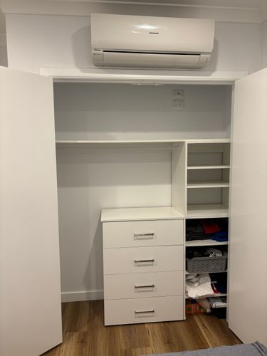

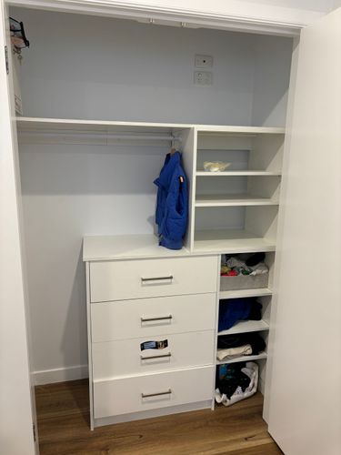

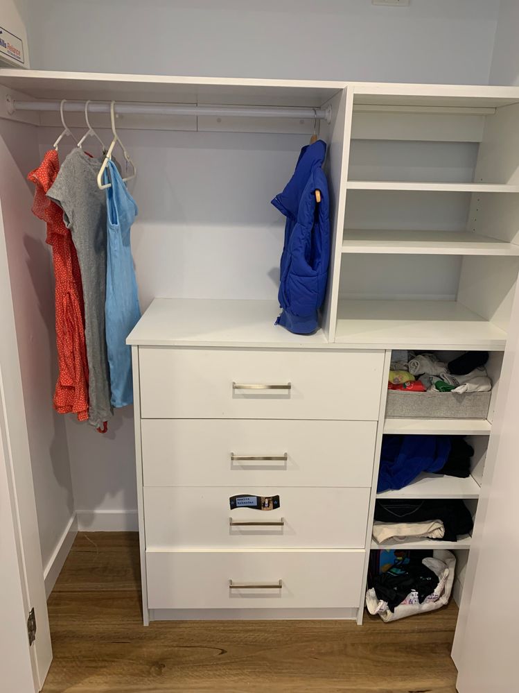

One of my niece’s has three built in wardrobes that were built to suit suit her young family, now they are growing up, the robes need more longer hanging space and extra shelving, I reconfigured the area and built extra shelving for each robe and refitted the top shelving, giving much needed extra hanging space and more shelves.

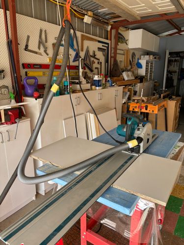

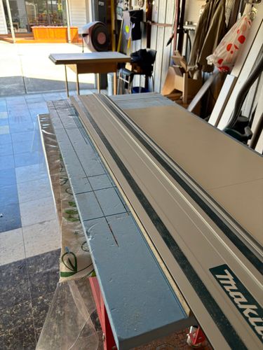

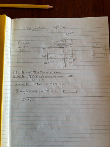

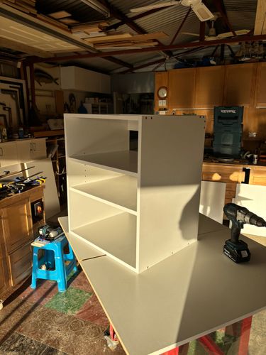

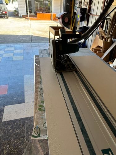

Measure and cut melamine sheets for shelving unit
i used a Makita track saw, I was surprised with the finished cut edge, no chipping of the melamine, this track saw allows a scoring cut of 2mm, then the full cut , reducing chipping.

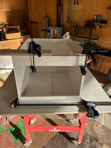

Step 2

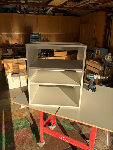

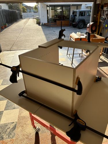

Install edging, drill shelving pin holes, using home made pin shelf jig

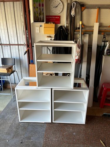

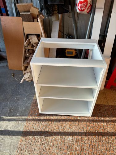

Measure cut adjustable shelves, install edging.
Fit adjustable shelves
In
Step 3

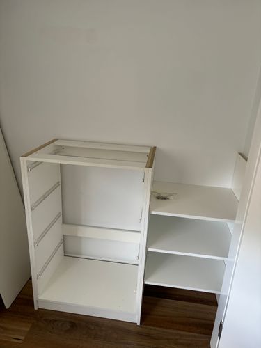

install existing shelves and drawers.

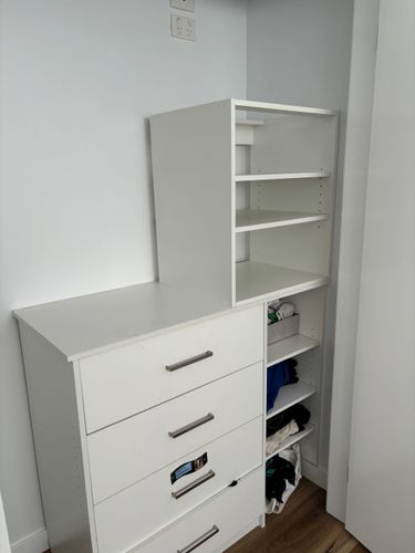

install new shelving
install top shelf and wardrobe rail
