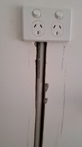

Recently We have Done work in Laundry to make Extra point And Electrician need to cut wall for this .Any Idea How to patch up and What to buy at Bunnings .Thanks
Hello @zenithpatel2002
Welcome to the Bunnings Workshop community. It's sensational to have you join us, and thanks for sharing your question about filling in cut gaps in your brick wall.
I suggest using Dingo 10kg Mortar Mix to fill in the cut channel in your brick wall. I propose mixing it thick like toothpaste so that it will stick to the wall and not slump down. Please make sure to give the mortar enough time to cure before painting over it. If you paint the repaired area too early moisture from the mortar will rise up and make the paint peel away. I also suggest having a look at this discussion - How to patch internal brick and render after chasing? by @tizaks.
