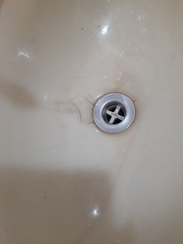

I'm about to use Rustoleum Tub and Tile refinishing kit on my bathroom vanity.bowl. The Bowl has some hairline cracks in it. Do I need to seal these or would the Rustoleum fill and level these cracks out?

Thank you for your advice. Here ius a picture of the cracks in the vanity.

Thanks for posting that photo of your vanity basin. If you run your finger over the crack and you can't feel the crack and it seems like it has formed under the ceramic glazing, then there is no need to use any form of filler. But if the cracks have affected the surface of the basin, then you'll need to apply several more coats to the affected area as Mitchell has mentioned. The crazing is still very fine and has not completely deteriorated the basin.
Hi Eric. Thank you for your advice. When I run my finger over the cracks I can feel them. I aim to use 2 coats on the Bowl. Instead of having to put extra coats on could I just fix the cracks with Gorilla glue prior to painting?

I suggest using Selleys 50g Knead It Aqua Epoxy Putty. Mix it very well in your hand and push it into the crack as far as possible and then feather the surface so that it is at the same level as the bowl. Make sure to give it enough time to cure before painting over the surface. It can be sanded down if you wish, but it's better to level it as flat as possible.
However, if the crack is too shallow, I suggest using Gorilla 59ml Glue Bottle - 59ml. It's temperature tolerant and is waterproof.
Thank you Eric. You have been a wonderful help. I think I will go with the Gorilla 59ml glue bottle. I guess I should just sand that down afterwards too.
Yes, you can sand it down so that it is at the same level as your basin. Please make sure to post a photo update. We look forward to seeing the results of the painting revamp.
